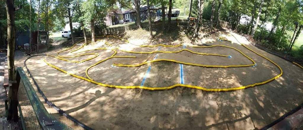

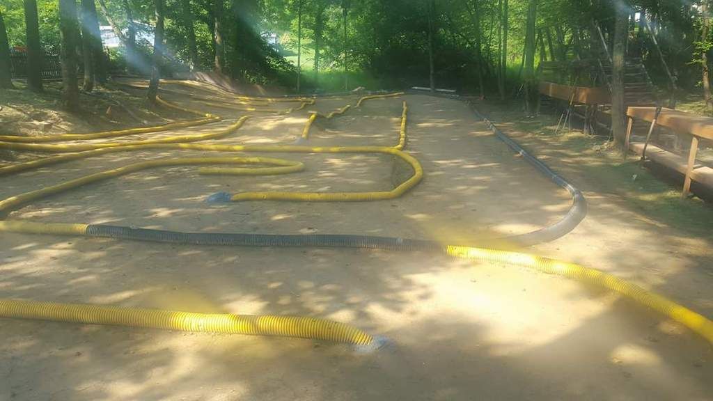

Outdoor, tight, med grip. Lots of tight turns on this layout.
Bottom pic is of previous latout, but, gives a better idea of size.

I would recommend this setup. You can put these pistons and oil in the 2.0 shocks but would have to run SCTE springs.
