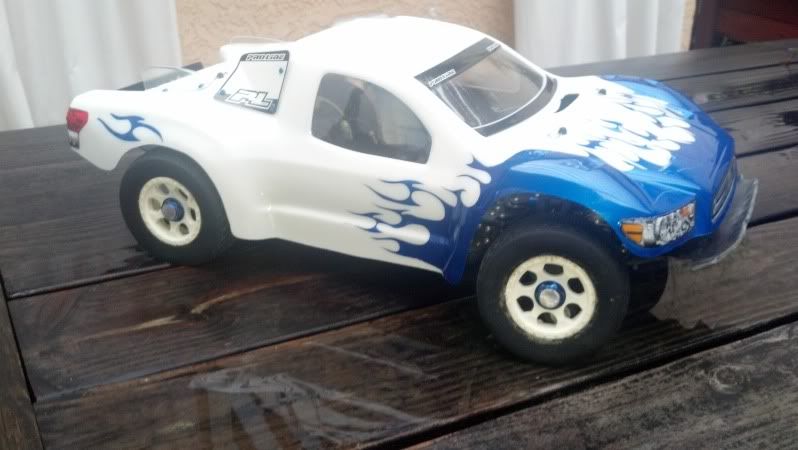

DE makes SCT wheels with a 17mm hex and 0 offset.
I converted my old MBX-5 and its been great. You may not need your track to carry parts... haven't broke anything in 6 months of driving it (something like that).
The MBX-6 conversion has a thread with a Google doc that has all needed parts listed! for the conversion. Cut the front arms down 5mm, rear MBX-7 arms, MBX-5 cvd's for the shorter arms. That about it for the chassis.
As said, tekno looks to be a performer.
Caster has one, the kriostasis rapture... very Mugenish.
http://www.rctech.net/forum/electric...riostasis.html
And the so far do it yourself Mugen conversion.
http://www.rctech.net/forum/electric...l#post11693321
Much more planted, more efficient drive line, stronger drive line, much better flight characteristics, better acceleration.

Works unbelievably! Yes, in 1/10 SCT class. Just gotta narrow it to Max width and run 1/10 motor and 2s. Bumpers, SCT wheels & tires and SCT body... that's the only rules.
On the layout that was in when it took its maiden I used to run 25's and went down to 23's
SCTE is a great truck. IMO conversion trucks are greater

My dad built the conversion of the RC8.2e into a 10th scale short course truck.. the trucks works amazing.. its the heaviest truck in the class on race days but handles the best. Im still a new driver I have not been driving for a year yet, but had an sc10 4x4 and now just switched over to this... WOW.. truck just works!
We are running the Tekin RX8 and Tekin 4.5 redline 550

Width is 305mm, to wide without modification. Would guess having to take about the same width off my Mugen that you would need to run front center cvd's in the rear. My fronts didn't have to get changed, they are real close but plunge is ok.
Besides making it narrower to fit in class rules (296mm) it drives better to me. Better rotation in turns.
