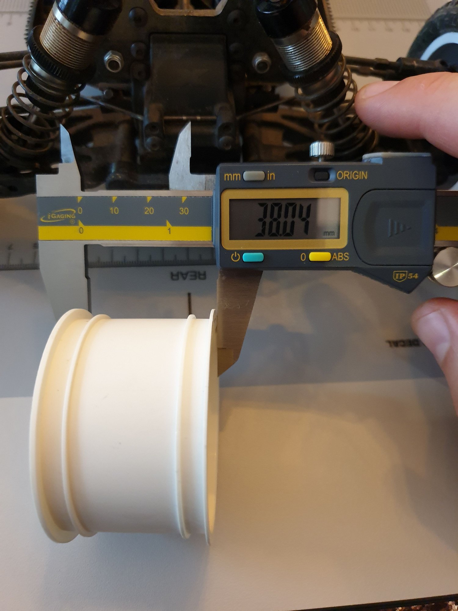

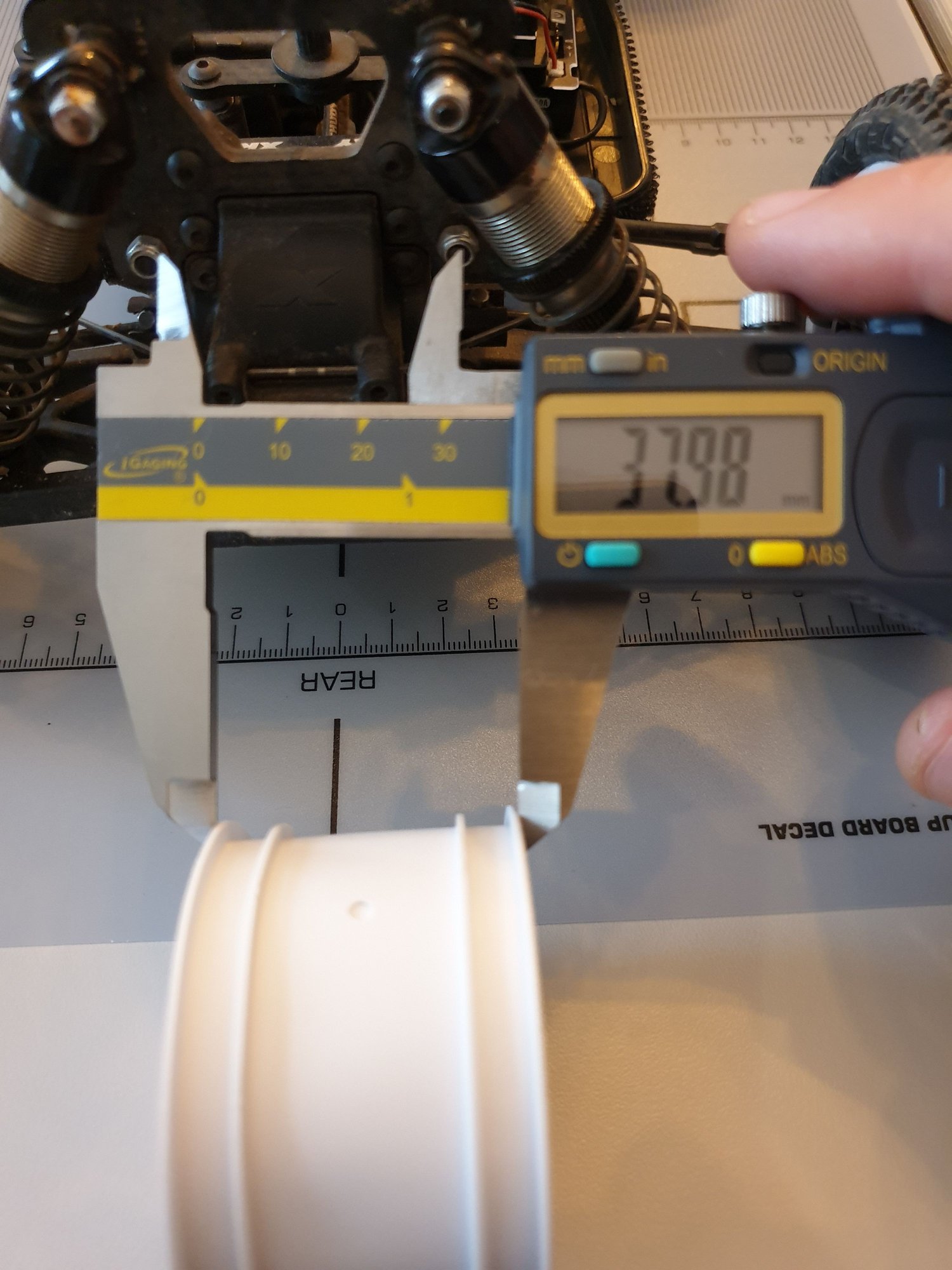

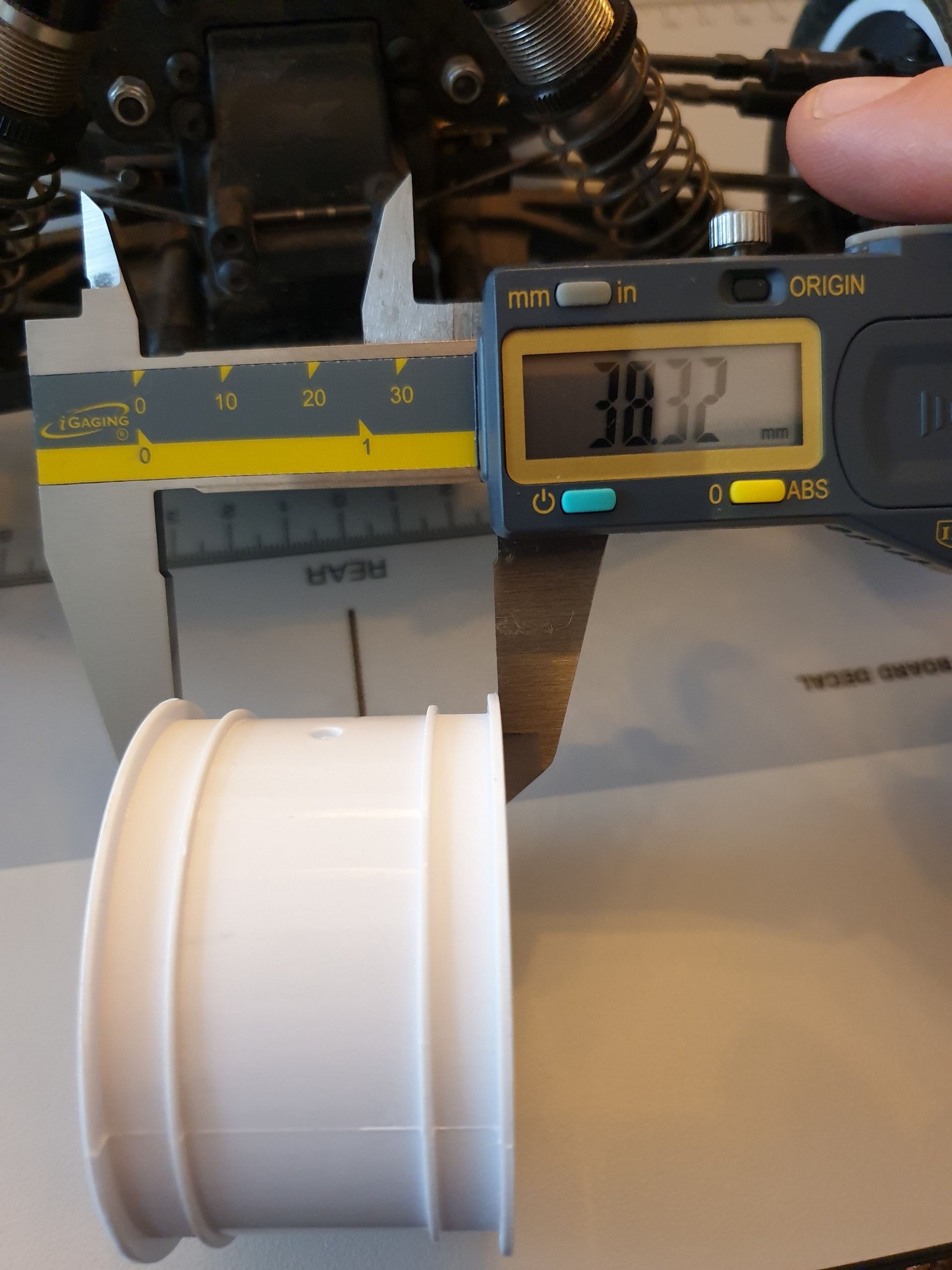

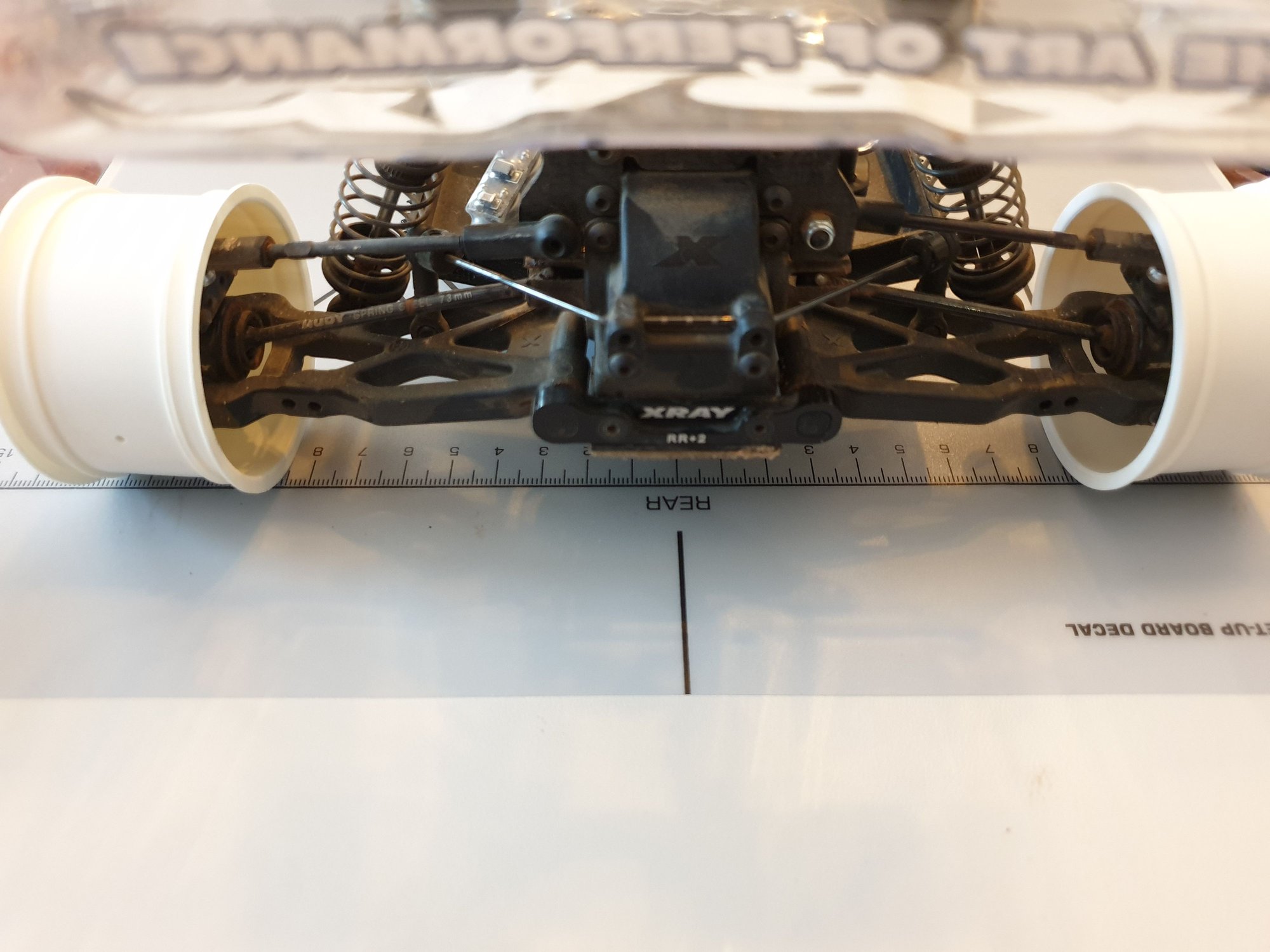

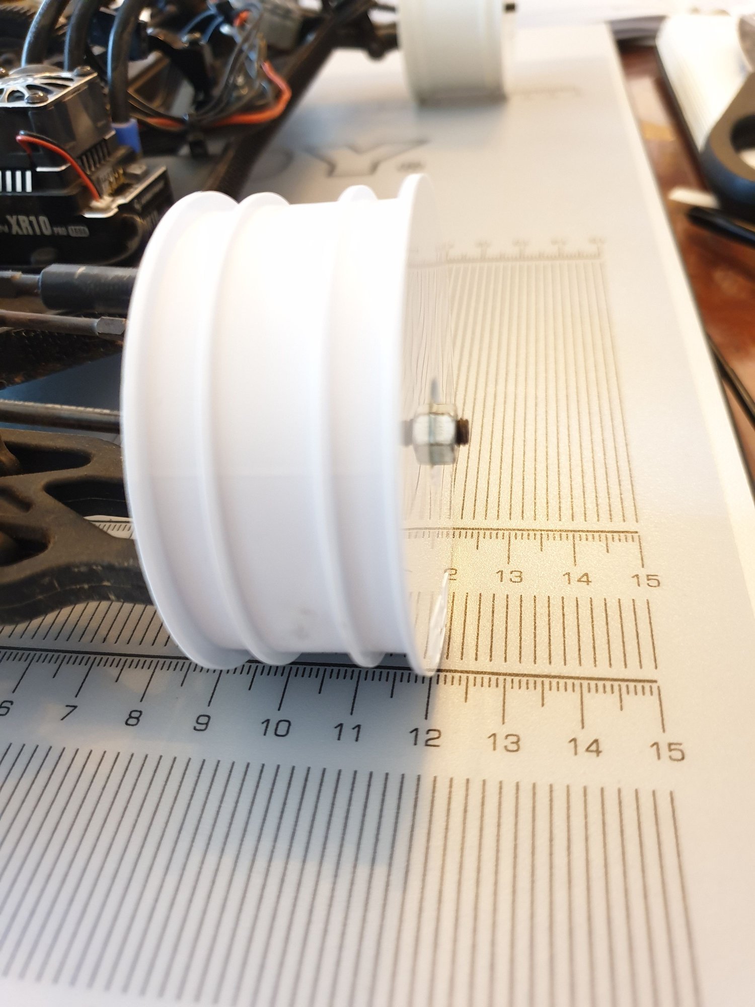

Ok
So this has been asked a number of times without a clear answer so figured I'd spend some time measuring my 2019 xb4 up with different wheels.It is worth noting that according to proline support the standard velocity rears with 0mm offset are what is used by Ty Tessman and they do not recommend running different offsets.
stock 2019 xb4 wheel
jconcepts mono rear for xb4
proline velocity rear (hard to measure due to the way it concaves)
So, from a pure rim width perspective the jconcepts is (unsurprisingly) the widest, followed by the xb4 oem and the proline the narrowest - there isnt much in them though.

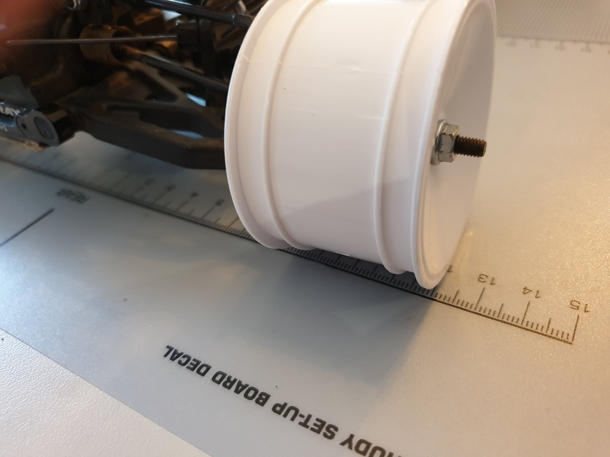

So lets check them on the car. For measuring a ride height of 20mm front and rear was used. I am using 2019 stock rims for whatever im not measuring (so when measuring the rears im using 2019 stock rims on the front, when measuring the fronts im using 2019 oem xb4 rims on the back etc.)
Stock oem 2019 rears - measuring 123mm per side (246mm total)

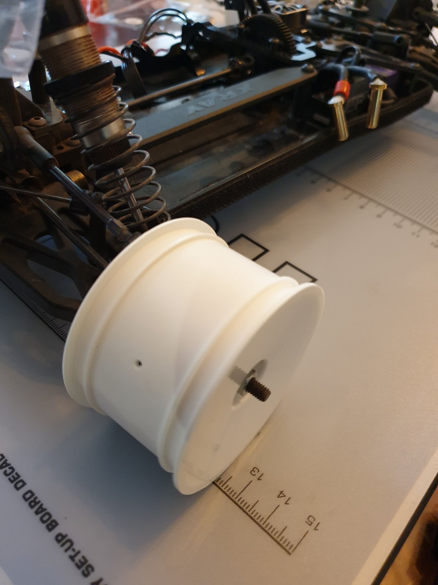

Jconcepts rear - 121.5mm per side (total 243mm)

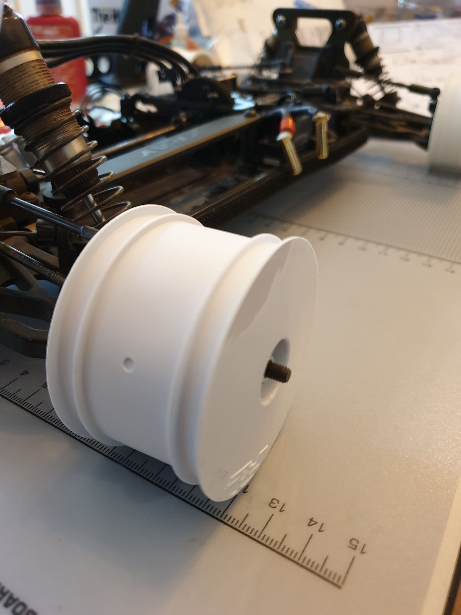

Proline rear - 122mm per side (244mm total)

So. From a purely make same as stock perspective it would appear as though you would need a +1.5mm offset for the jconcepts and a +1mm offset for the prolines
The fronts managed the same (121mm per side) for both the oem xb4 and the proline velocity xb4 rims. So, no different hexes required to compensate.

You can use the stick that comes out of the other end of your calipers for offset measurements. Lol. Just lay a straight metal ruler across the wheel.
Then I label my wheels wide or narrow track width. Generally, I just sharpie along my tires on my setup board to get track width.
