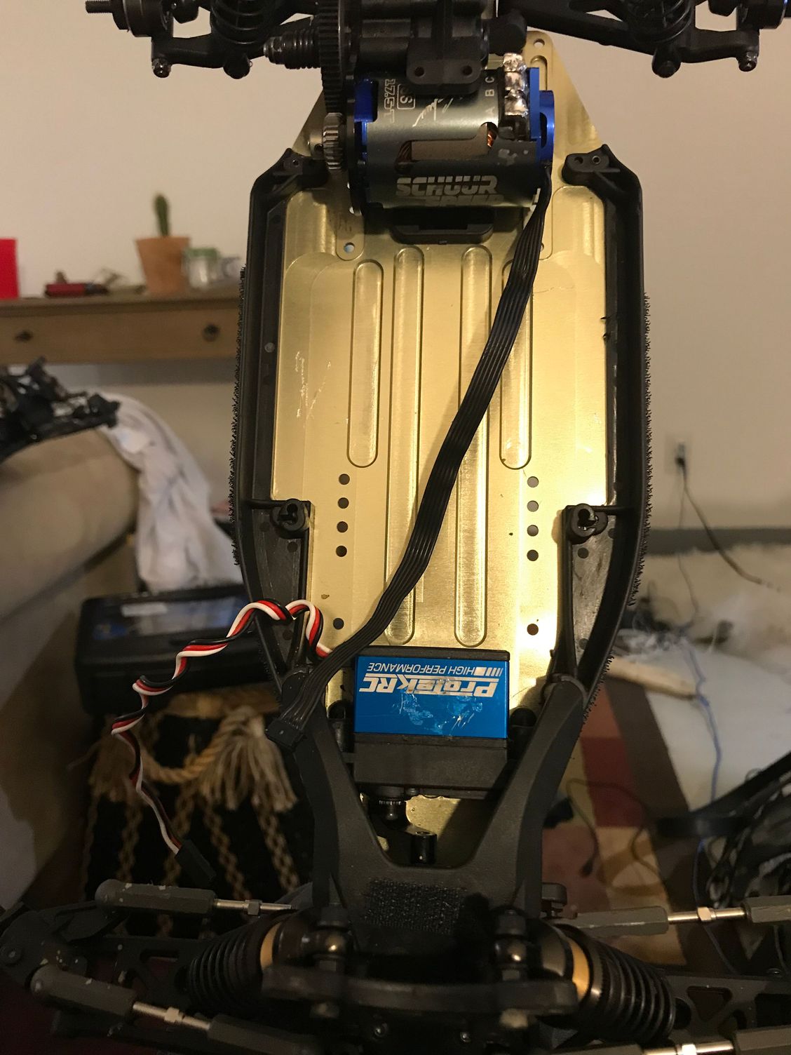

hey guys, please see the image below, and im sorry if someone has already asked this.
Im somewhat messing around here, and lowering my weight, but, the back adapter pieces that are gone on my picture, and its just basically the motor and the block underneath - di you this that will work fine? the pieces i literally took off where two bracks, the front one with two posts, and the rear stuff by the motor the battery tucks into.
The reason i wanted to try this, is because im trying to do double sided tape on the battery and put it in a further back location.
thanks

Are you struggling that much for traction? Indoor? Consider a softer tire? Sometimes the LD tranny is not for everyone or everyone’s style of track/surface....

hope someone can help me out here on the photo above.... thanks
It will work without the water fall, in fact guys are running it that way to help with traction(fchassis flex).
awesome wanted to see what you guys thought.. yes i heard about the more flex. so good to hear that again immediately in a response. thanks!
thanks
I switched my car to no water fall and made a huge improvment on my track. But I did not move the battery all the way back it's about 17mm away from the motor . I'm running pink rear white front springs and it's a rocket.
Also using the rear front brass hanger
