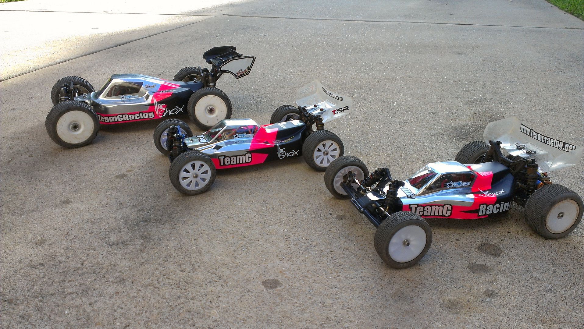

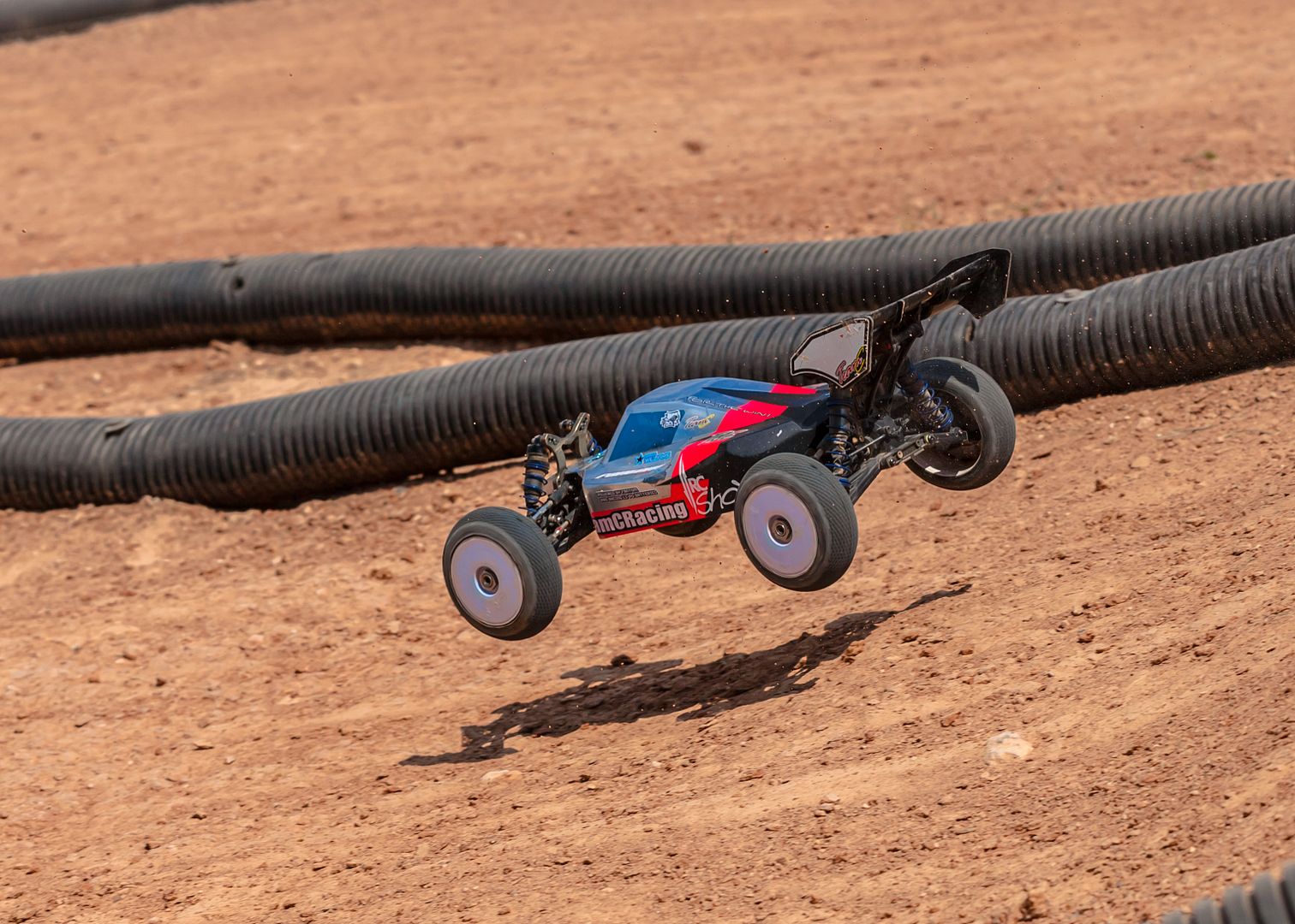

The quality of the kits are second to none, VERY good tolerances and are engineered well. I have 5 Team C vehicles and they are all top notch. Off subject but here is my Team C GT8L nitro and my other rides!
