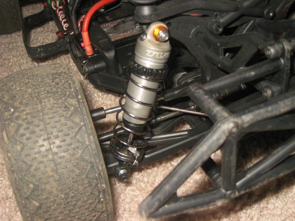

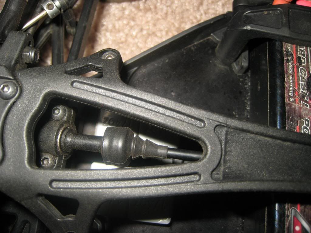

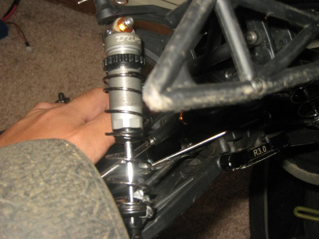

Originally Posted by nicholasxuu View Post
Finally bothered to paint the stock body, nice body with a lot of stickers to use.
Also, added a wing to the rear. Using (recycling) broken 1/10 buggy wing. No idea if it's working or not.
Used some parts from axial exo to organize the wires.
Stoch servo arm feels soft, upgraded to metal ones.
Also used TLR ball cups to help accuracy, in my mind.
Put some black grease into the cvd, and used durango's cvd gloves to avoid dirts into it.
The hole in spindle is 3.75mm, while the screw is only 3.5mm, I don't like the play there.
So I used a 4mm drill and expanded the hole. Used metal bushing to make the hole 3mm with M3 screws. The diameter difference is less than 0.1mm now. (Pink spacer helps to further reduce friction, and most importantly, I don't have 1mm shorter screw in my box :P)
Did the same thing in the steering arm, see the metal bushing between screw and arm.
Used 7x8=56g of weight in the rear, supposed to solve the nose dive problem. Later found the nose dive is mostly because of the too soft rear springs, making the chassis bottoming out before goes into the air. changed harder springs actually solves the problem.
Here's the weird part, I got really tired of finding springs, and have bought so many TLR RWD springs, I went to bought a set of Ten-scte shocks instead. Surprisingly not that expensive, 4 shocks costs like $50 new. springs cost extra though.
the length fits perfectly, doesn't even need to add any spacer to limit travel.
Used ten-scte blue front springs (3.9) in the front. Pretty much all ten-scte front springs works. Green (3.6) and Blue (3.9) can make 22-24mm ride height though.
Used sc10 4x4 green front springs (3.5) in the rear. (it's weird but it fits just fine, and it's shorter so I can lower the ride height nicely (as low as 22mm rear ride height))
Not yet tried other sc10 4x4 springs.
Bonded the spring with lower cup, since the extended spring length is slightly shorter than ten-scte's rear shock travel distance.
used shock bushing come with the shock parts, nuts for 3mm shock shaft is a bit small, so added a concave spacer to hold the shock in place. looks nice too.
Today's practice video, not a very good driver, and the track is messy with 2 mini eight, sorry seems forgot to clean the lens.
http://youtu.be/EFVHFbCloVI

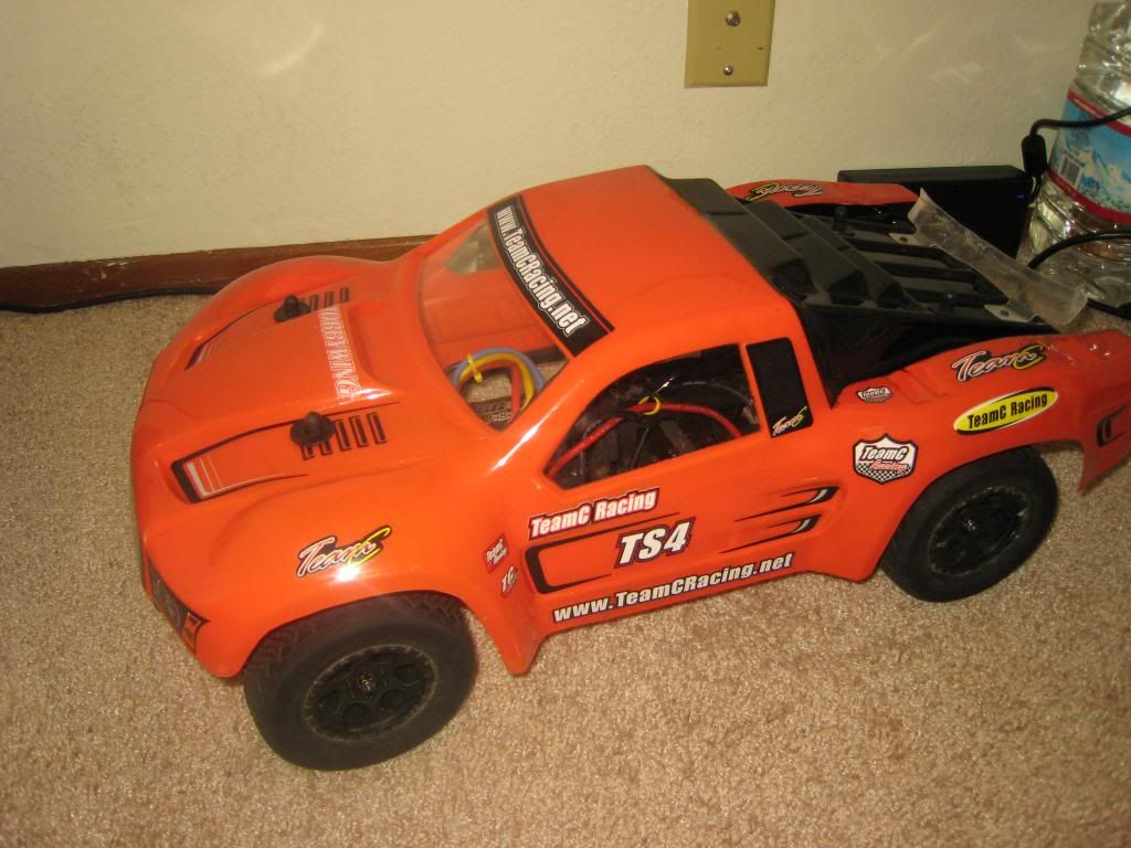

I raced my TS4 for the first time this past weekend. It was an out door 1/8 oriented track. It was a high traction big jump and tight corner type of track. The setup I was usin was one I tweaked out of the box. I used 5000f, 5000c, 2000r diff fluids and for the shocks I used 40wt in front stock piston medium stock spring and 37.5wt rear with stock medium spring. Shock tower I used center hole front and rear and on front arms hole closest to diff and rear arm hole closest to hubs. Truck was absolutely dialed. I am going to run this same setup indoors on a 1/10 track and see how it goes this upcoming weekend. I will keep all posted. The only changes I would possibly suggest or may try is front arms switch to outer hole with shock and a 7000f diff. I'm also running the inside holes on the Ackerman and 13 degree caster up front. I did switch from ball cups over to Dubro ends EXCEPT on the Ackerman. Anything bigger then the ball cup will interfere with steering. I also am fortunate enough to have the new TS415 chassis. It is very nice and makes it feel more stable. Not a necessity but nice upgrade none the less. I'm going to keep testing and tweaking but my above setup so far has been dialed on 2 different tracks. Hope this helps. If anyone has questions or concerns don't hesitate to ask. Below are pictures of the chassis and Dubro upgrades

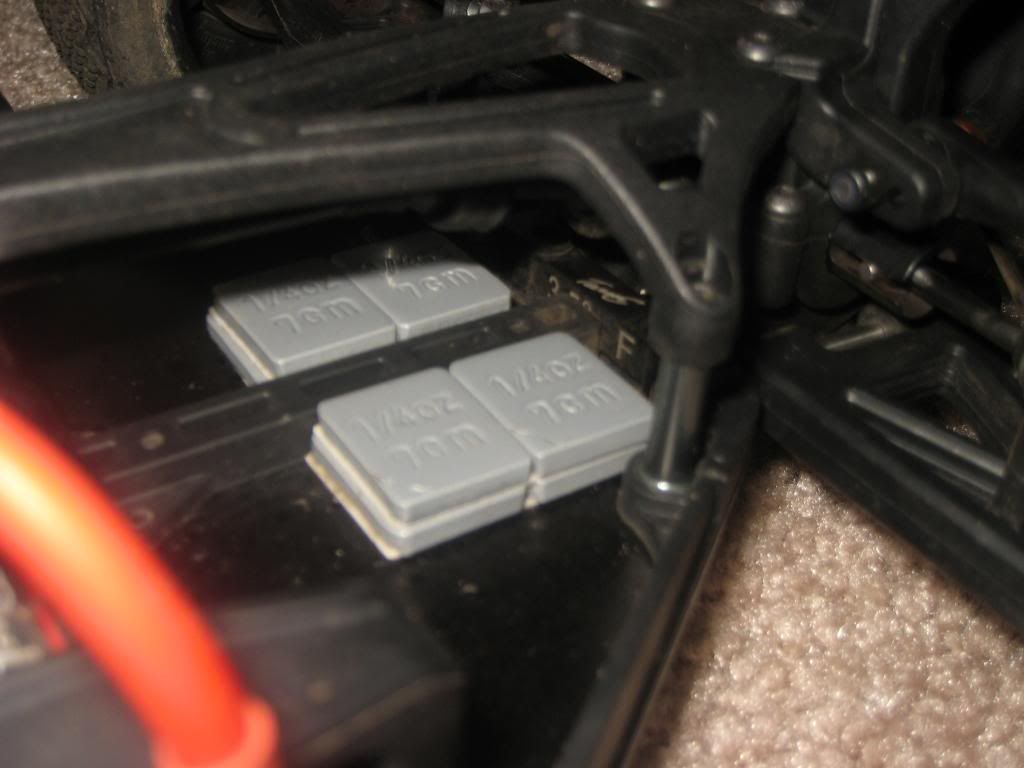

Here is the chassis
8drenlnjunkE is offline

Originally Posted by 8drenlnjunkE View Post
Here is the chassis
You got purrty legs, boy.

Originally Posted by symmetricon View Post
Hey Nick, if your truck is bottoming out, it is not the springs fault, there is not enough pack in the suspensions dampening. You should try thicker oils, or pistons with smaller holes or less holes. This is exactly the reason Marcus made the 2 stage piston for the truck, with the stock pistons, you have to run real thick oils to get enough dampening.
bottoming out before the jump, it's a relatively slow compression, damping doesn't play a big row here.
I was using 27.5wt losi oil, with tlr 56 pistons in the rear, it's already very thick for the rear.
I'm currently using 17.5wt losi oil with ten-scte stock piston, much less damping than previous setup, but with hard spring (3.5), it's working pretty well.
nicholasxuu is offline

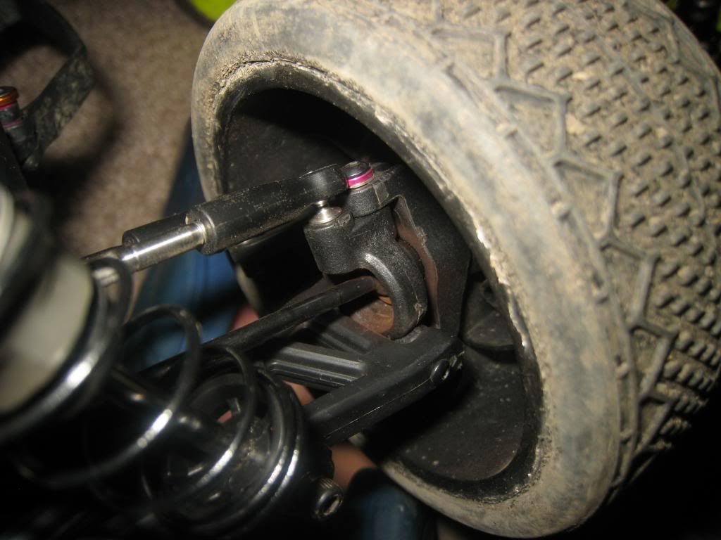

Only upgrading rod end is not going to solve the whole problem, you want to maybe use a spacer to make it captured rod end.
at least, you want to make sure the 4 rod ends in front and rear shock towers are captured.
