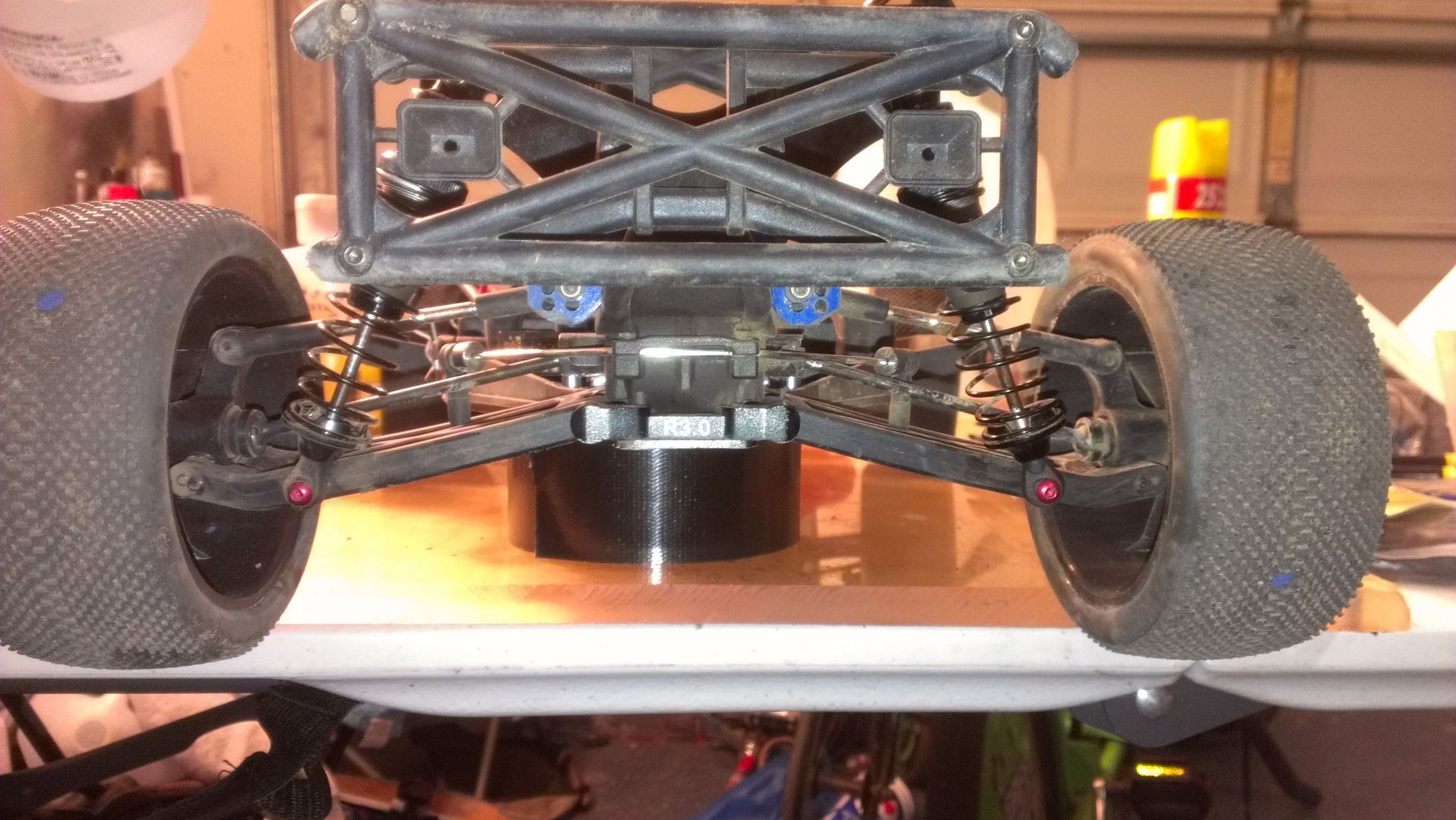

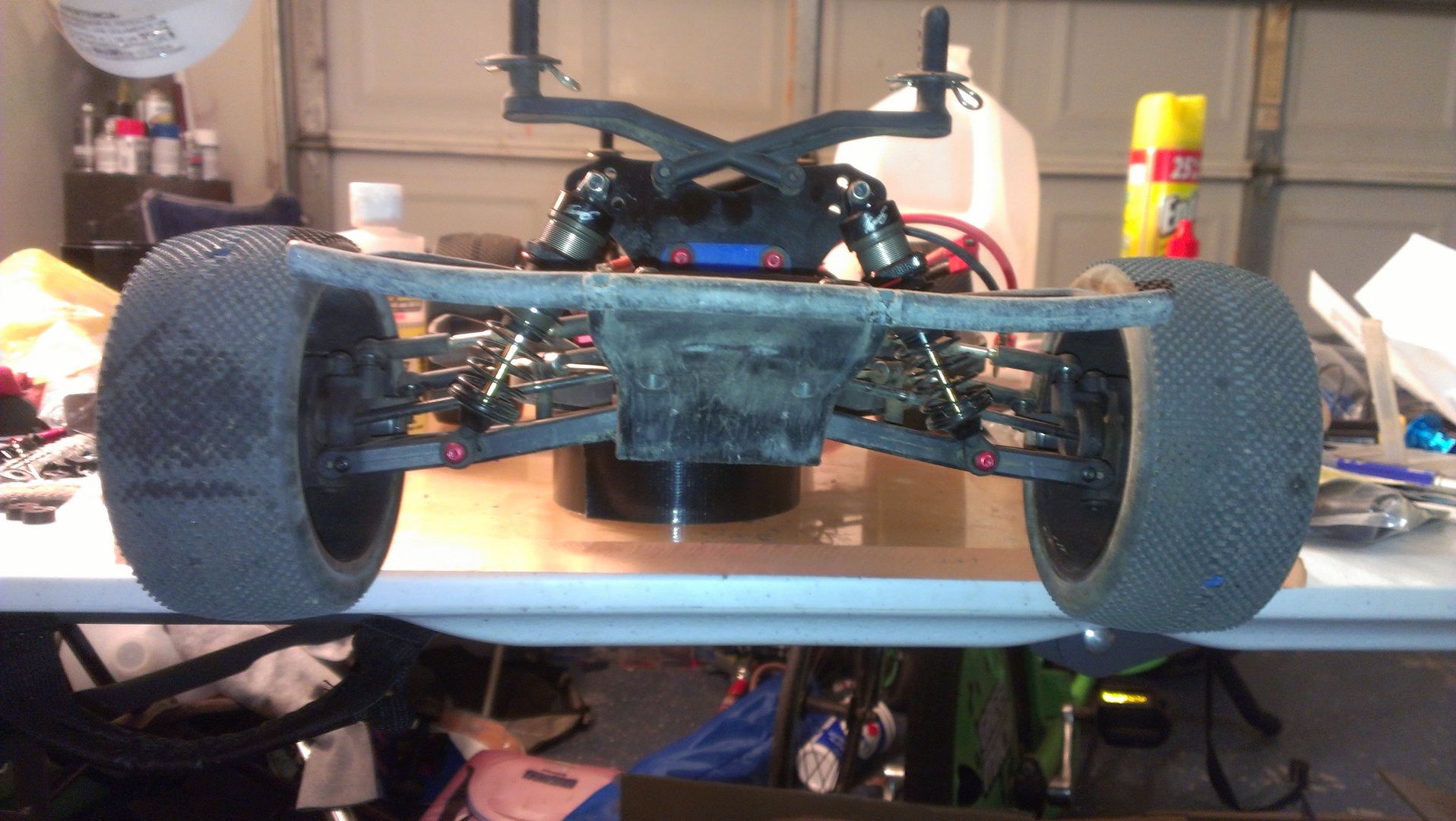

Tested new geometry shock towers yesterday!
Rear with 2.5mm internal limiting and inside holes on arm, Std TLR22 rear springs (not the 22T springs)
Front with no limiters and std 22B springs outside arm holes
The added droop is wonderful on this truck, it allows you to run the ride height lower and really absorbs the rough sections much better with out bottoming. since you can run the outside holes on the arms the front is more stable. Also the driveshafts do not hit the cups and you dont have to add external limiters.

Looks great Marcus!
