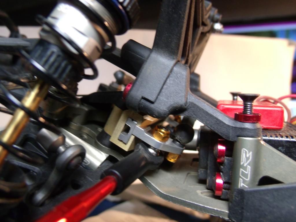

I'm just having no luck with after-market steering sliders. I thought I was okay with the Aluminium slider and housing rack. Seemed to work okay when the track was dry, as long as it was generously lubed with WD-40. Unfortunates, it locked up on the first practice lap before racing today when the track was wet. The AL sl;ider and housing already has some play that was noty there when new. Loose wet dirt / mud from the track gets in the works and grinds it to a hard lock. I had time to rebuild the front end with the stock steering rack. But even then, it just didn't track right all day, and to make matters worse, I kept popping a ball cup off one of the steering links. Once during a heat race and it popped off twice during the A-Main. Guess they are stretched out of shape from the stress of the rack locking up. I'll have to install new ones -- again -- and recheck the whole front end to make sure nothing else is torqued out of shape. Oh well. I'm back to the stock rack. If it wears too fast again, maybe I'll try the Exotek solution. For now, I can wait till I'm sure nothing else needs fixing.
#7675
I WD40 it.
Check Page one of this Thred.
