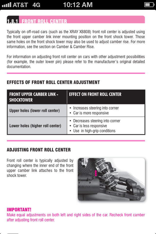

I suggest you read the Hudy book on roll enter:

http://losiracing.blogspot.com/search?q=hrc
am i right or wrong?

Just good general info.
http://www.ocrraceway.com/setup%20sh...et-up_Book.pdf
It will apply generally for all vehicles. Dog bone "plunge" may be more model specific.

Guys the hudy guide is amazing and a great reference but 4wd and 2wd cars don't always react the same way to the same changes due to the dymanics of the front tires pulling the car through a corner. Be careful when referencing this when it comes to a 2wd car. This is a GREAT guide for any 4wd vehicle though.
This is true. It's more general info. The principles are the same, but your application to a 2wd vehicle is going to be different for exactly the reasons Casper states. A 2wd setup is going to be different than a 4wd setup.
when I was reading that page, i thought it didn't sound right for this truck.
good thing this is a thread dedicated to a 2wd truck.
