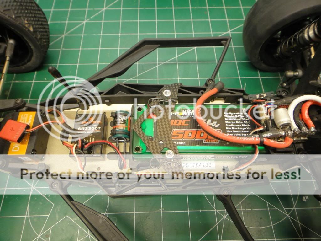

well after seeing a post by user "Mitten" about his battery hold down I got to thinking and started to look and see what I had around to make one and this is what I came up with (not bad for free)
had some aluminum tube, M8 bolts & a carbon fiber tail wing from one of my heli's when you put it all together this is what you get
going to be testing this out tonight
the bolt heads stick out about 1mm should'nt be to bad not what I prefer but its what was on hand
