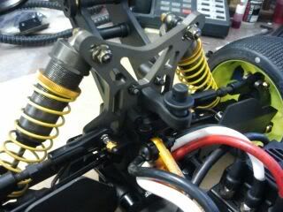

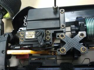

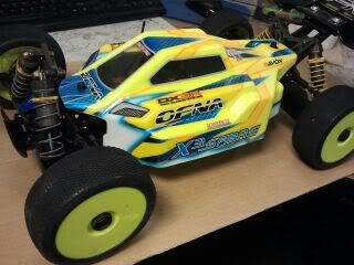

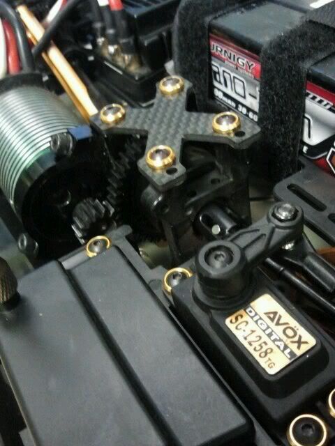

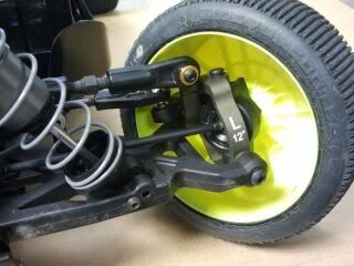

OK here are my pics from my car, I already have options from the nitro version on my car that bolts ups and will note above the picture as to an option.
12 degree cnc steering hub is an option 41534,grey spring front 41030
carbon fiber x-plate comes with the kit along with cnc diff crosspins for the internal gears and the outdrives are lightened. composite 46 tooth spur. Aluminum clamp style motor mount.
Front and rear aluminum chassis braces also come with kit along with composites
cnc rear upright is an option 41414, lightweight outdrives on the front and rear, all outdrives fit front center and rear including the nitro buggyand come stock in the kits. CVA's front,center and rear, all hingepin holders are aluminum.

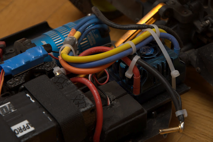

In Sweden at least we buy the X3E as electric kit, no nitro stuff included.

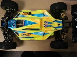

Som pictures of mine:
Just did my first driving / race with it last weekend and I really like it. Just as the X3 nitro, it's east to go fast with. :-) Only changes I made from stock is Hong Nors blue springs on all four and the silver roll bars front and rear, moved out the shocks on the arms booth from and rear. And it's spot on!
