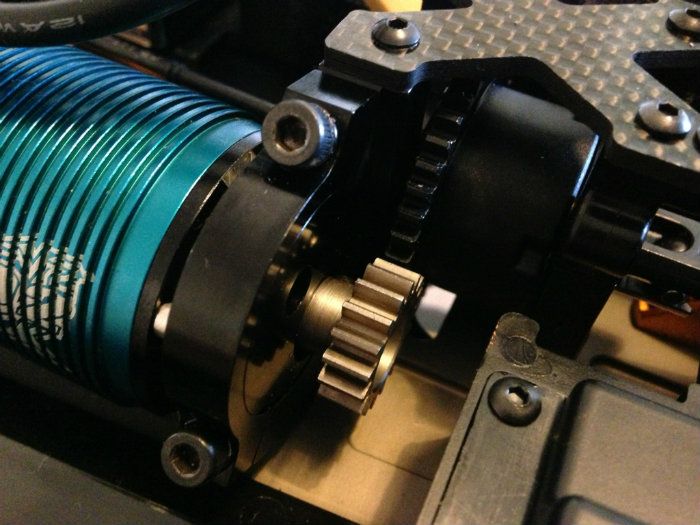

looks good AJ, might I suggest a couple of tweaks to keep your car more durable, the wing mount I use longer screws that are flat heads with conical washers so the the screw mounts at the end of the plastic rather than the countersunk area, this provides a stronger base so that if you somehow land really hard on your wing it will keep the screws from pulling through. Lock tite the diff mount screws from under the chassis as the will flex out and unscrew. A Mugen body mount set up works good as the body will sit a little higher for more clearance (MUGE0153 MUGE0803 MUGE0181). And also spray out the set screw and pinion as it has machining oil on it, spray it with brake cleaner then use thread lock, it may not seem much was on the the two items but after a run or so it tends to unlock easy.

Funny you mention all that, ive already done the wing with 14mm cap heads and thread locked the diff screws in to the alloy motor mount, also blue thread locked the pinion (now running a 17t and 44t steel spur), but i boiled up the the rear body mount to give a bit more flex, but if it does break i will upgrade to the Mugen parts

The stock 46t spur with a 16t pinion wasn't quick enough for my liking with the 1850kv motor, so i sourced a 44t steel spur and upped the pinion to a 17t, its pretty spot on now
