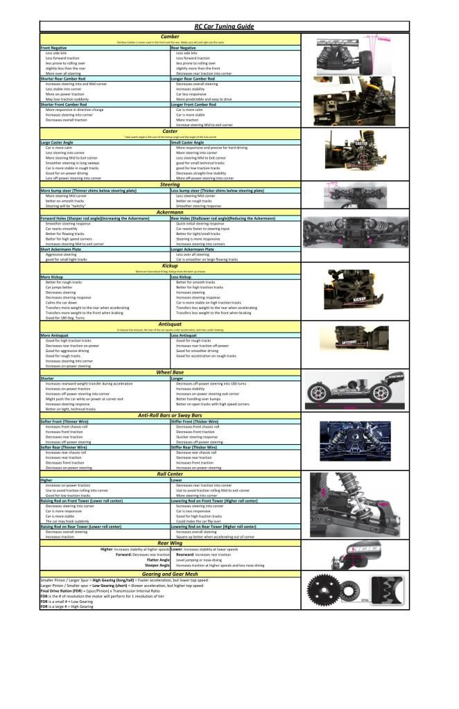

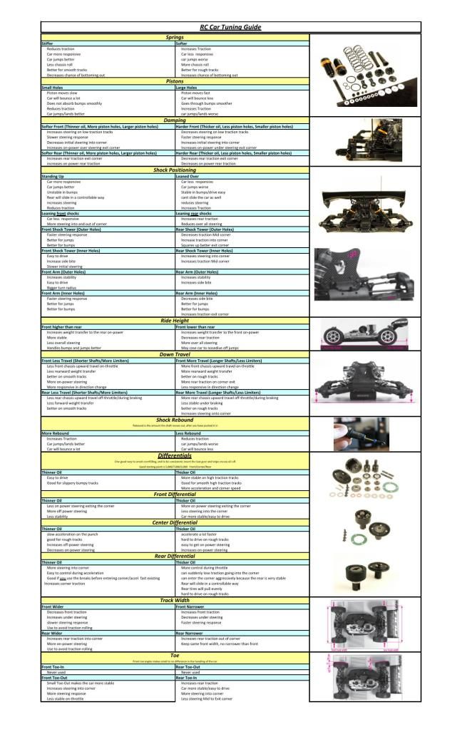

[QUOTE=sffan15;11149067]We should start a page that shows a simplistic diagram of all of these things. Would be cool to include a list of terms used too, and description/picture. Would be good for some parts too. For instance, Danny talks about the akerman plate, and I bet alot of people go "who?" A list w/pics would be so simple to make. EB48 wiki anyone?
Like this!!!

Originally Posted by Allen Drebi View Post
Like this!!!
Yea, But it needs to be bigger or clearer. I cant read that. Looks like a cool reference chart though!!
Pm an e-mail and I can send a PDF
