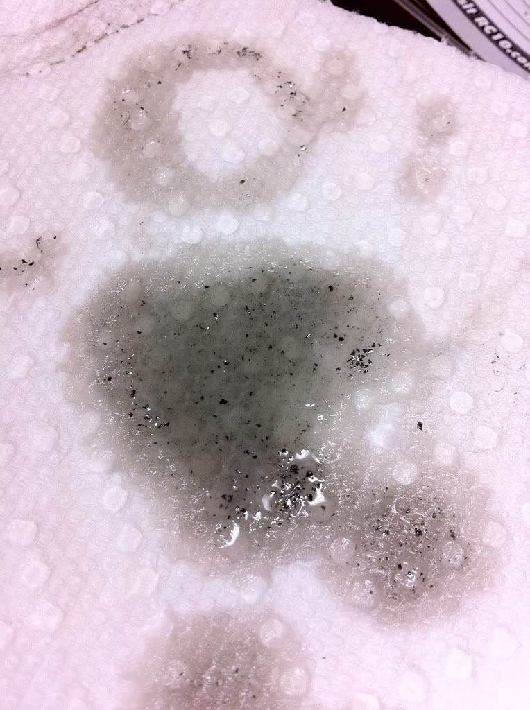

Finished the build. On the 2 rough diffs I ran them in a bit on the bench by holding one wheel and letting the other wheel spin. Took about 10 minutes of this going back and fourth between wheels and in forward and reverse but they smoothed out nicely.
This is a pic of the metal shavings that came out of the diff after that break in. If you had a rough diff that you needed to break in I'd reccomend changing the oils as soon as it smooths out. This doesn't seem like something you want running through the gears for too long.
Other than this the build was smooth. Can't wait to get it on the track. Just gotta get the paint on it now and it's all set.

holy crap!!!!!!!!!!!!!!!!!!!!!!!!!! i wonder if the nitro is the same way???????????

I just built 6 AE 8.2 diffs. They all went together smoothly. MAKE SURE THAT THE RING GEAR IS STRAIGHT ON THE DIFF CUP BEFORE YOU TIGHTEN ANY SCREWS. A crooked ring gear will lead to exactly what you guys are experiencing. These diffs are buttery smooth after a little run in. THe diffs can be slightly notchy when new but they should spin. ALso when you place them in the bulkheads. Make sure to not overtighten the horizontal screw that holds sway bar holder on. To tight and it compresses the diff case.... I am really enjoying this buggy
