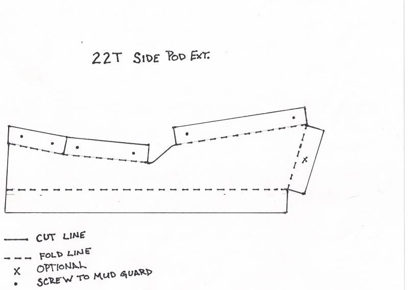

I finally got the time to finish up my side pods and the rest of the truck. I just need to paint the shell. But for right now I'm using my old XXX-T JConcepts body. It fits, just needed to drill new holes. There are a couple of other things I want to do to clean it up. But I can do those later, I just want to be able to get it on the track Friday night.
Mitten how did you make your lexan side pods, I noticed the 2 bodys have the cut out on the bottom, to me it looks like your have more material and I was just curious how you did your install looks very clean nice job!!!! any help would be appreciated.

Think this might be what you're looking for...
Originally Posted by Mitten View Post
I got to check out Truhe's car this past weekend. I really like the side pod, mud guard ext. things that he made. Unfortunately he didn't have a template to email me so I could copy them. So I came home and came up with my own and I think this is pretty close. Thought maybe some of you might want to give it a try for yourselves. I just used the corner of my desk and a steel ruler as a make shift break to bend the lexan. Hopefully you can just copy the image, print it out, and trace onto a piece of lexan. If you cut the under flap piece off the body you can use that as a guide as well. Then velcro the body to the ext.

^What Slakr posted^ I don't know if you can print out the template that I posted and it be the right size. I could email you the jpeg file I use if that doesn't work. To fasten them to the mud guards I just used some 4-40 screws cut to length.
what size drill bit did you use to make the holes
RB5SP is offline
Old 01-24-2012, 11:10 AM
  #1882
iTrader: (25)
Join Date: Nov 2007
Location: Ohio
Posts: 269
Trader Rating: 25 (100%+)
Just used a body reamer on the side pod, made so the screw slid through freely, then 3/32 into the mud guard. I had one person interested in buying a set. I really didn't think about making more to sell, but if anyone is intereted lmk. I can paint them black or leave them clear. $10 shipped. PM me if interested
