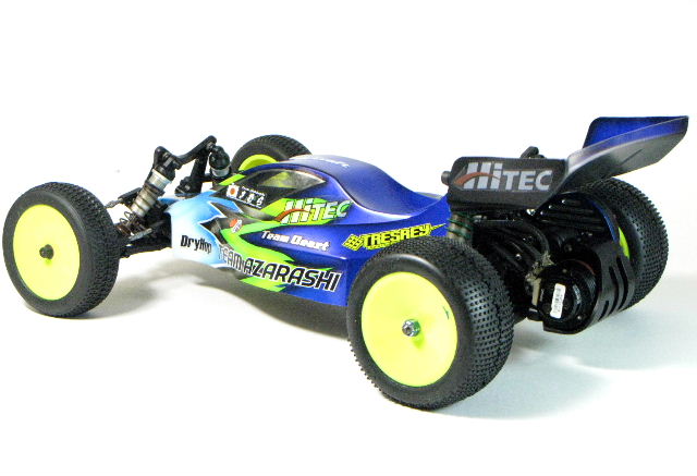

This is a new Azarashi wing, but is the body in the pic also from Azarashi?

i think that link died mes. i checked on team azarashi's website and saw some bodies that could be a possible canidate for the bmax2.

Try to refresh the link, I had some issues with it, too.
The bodies above are from BugleBoy Racing AFAIK. The Aralgo is really nice, just like the Daedalus X12 body on the Azarashi blog.

i got it this time. not bad looking wing.
