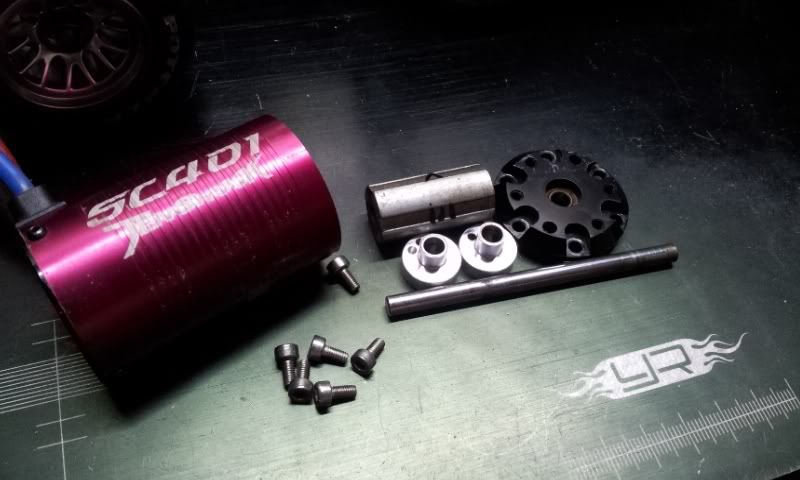

why this happened ???
i need to race on this sunday.............
Marco926 is offline
Old 08-26-2011, 11:52 AM
  #733
Ridley's Avatar
Join Date: Dec 2008
Posts: 1,460
Trader Rating: 13 (100%+)
You delaminated the rotor. Can happen from being too hot. You can glue it all back together with permatex green sleeve retainer and be ready to race in 12 hours....assuming it didn't get super hot and you messed up the stator.
Your bearings look either dirty or rusty..make sure those are ok as well. The markings on the end of the output shaft looks like you possibly had a bearing seizure.
As you cannot re-balance the rotor obviously, offset the drilled holes in the rotor endcaps to split the weight difference. Thats what I did on mine and it has worked great...I've been loaning it out all summer for guys to try out the Tenshock.
