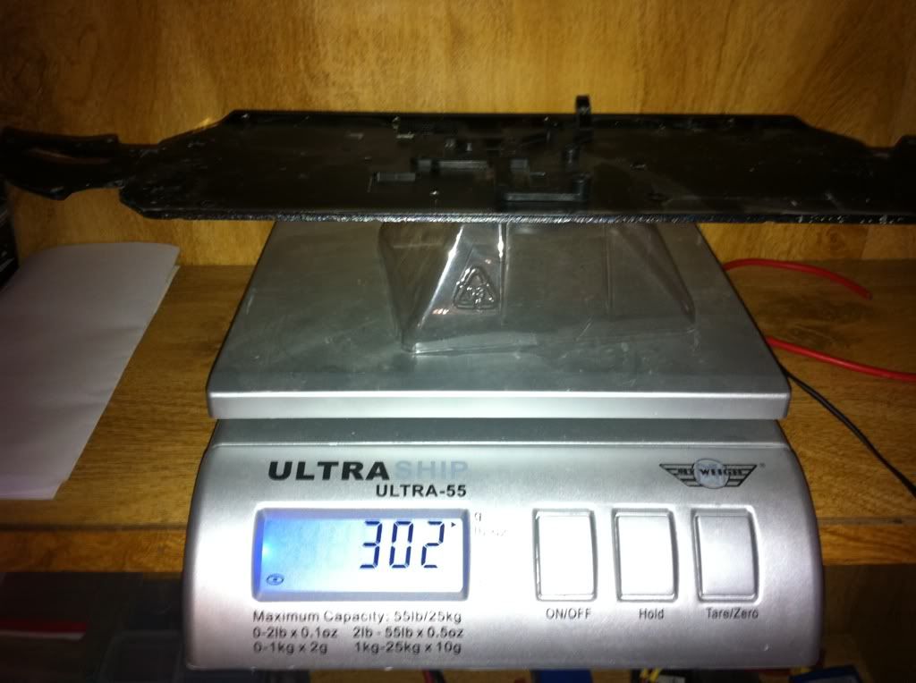

Got my BCE chassi today. Not exactly thrilled with it considering it was $100 it had a few issues.
First, all of the holes were not countersunk. I had to put it on my drill press and countersink 5 holes that were missed.
The screws for the battery tray don't line up well. I could get 2 of the 3 in but no matter what I did I couldnt get the 3rd in. Could only see the edge of the hole in the bottom of the battery tray thru the hole in the chassis. Had to open the hole on the chassis a little to get it together.
The aluminum hinge pin holders on both the front and rear would not fit over the chassis. The chassis was just a little to wide. Had to file the edge of the chassis down to get all of them on.
There is no anodizing at all on the chassis. It actually still had the 7075 paint markings that come on the raw sheet stock.
The good news is it's 62 g lighter than the stock part it replaced and the 7075 should prevent bending like I've done to 2 stock chassis now.
None of this is a game breaker and I was able to fix all of the issues myself but I have to say I am a bit disappointed having this come from a company with the reputation of BCE. I'm sure this is just first run issues that they will get worked out.
