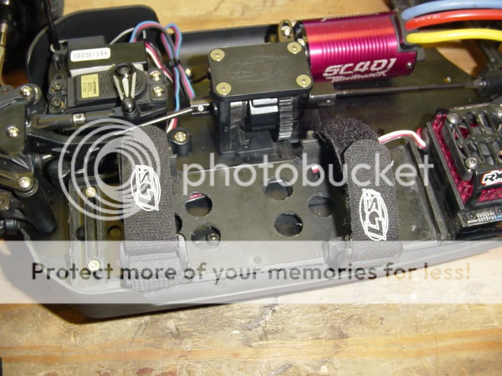

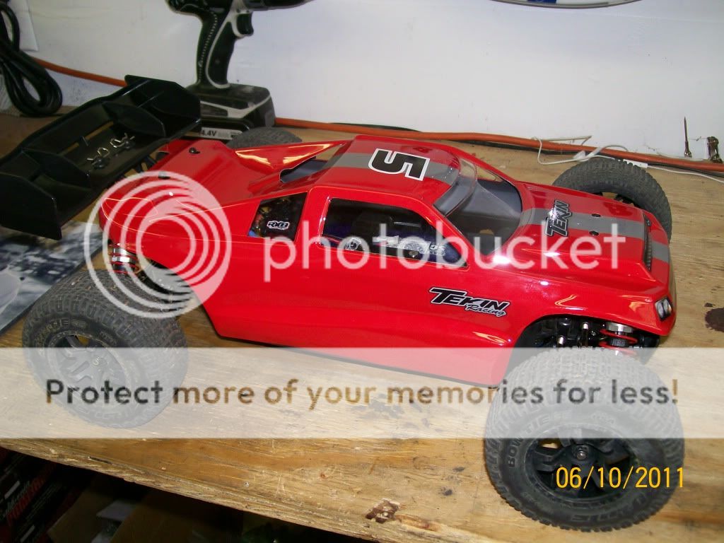

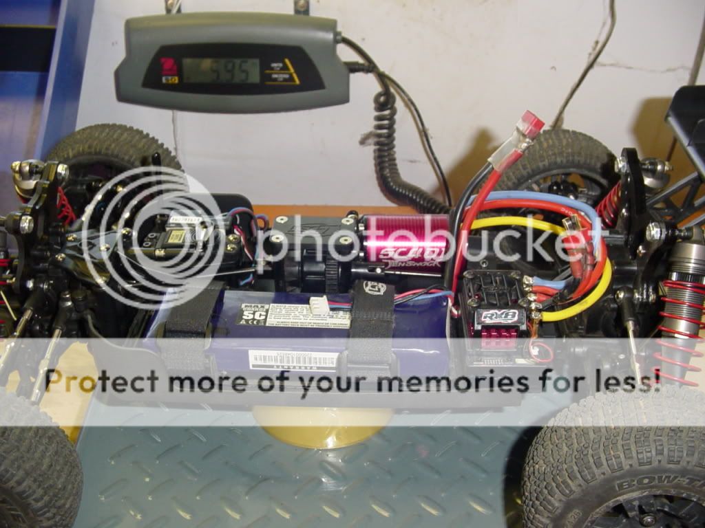

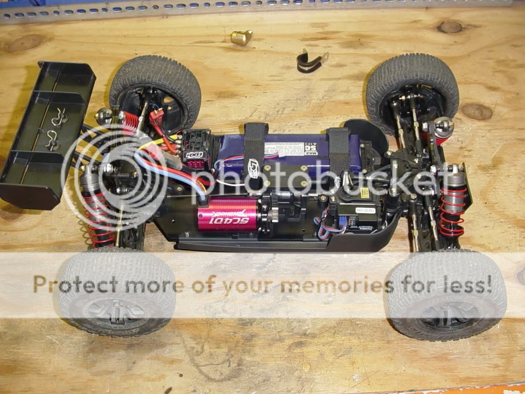

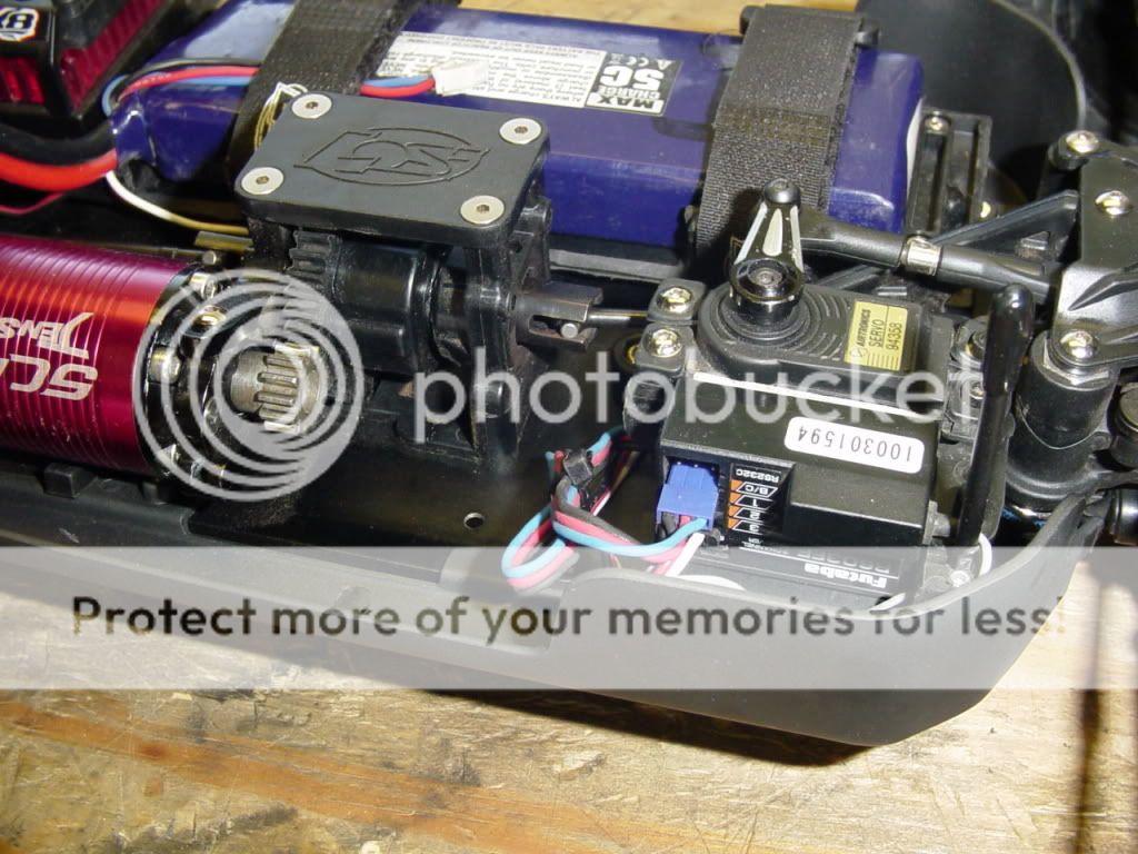

Just thought I'd share my SCTE/Ten-t/810 hybrid. Basically it's all the parts off my SCTE on a 810 chassis with a Ten-t wing and 8ight shocks.
With the Hyper wheels the track width and wheel base are both 12'. I don't run at any sanctioned events so I didn't worry about legal dimensions.
Lightened it up by modding the battery box, radio box and top diff plate. I'm doubled up on the shock towers because I regularly send the truck into spiraling cartwheels. Bad enough I've broken/bent any single tower I use; carbon or aluminum.
I've tried the 17mm hexs and axles from the 810 with 1/8 buggy rims/tires but didn't care for it to much. Besides, I have a ton of SC rims/tires I need to use.

Did you double up on the front and rear shock towers?

Yup. The front is a 3mm carbon from Jammin and oem rtr aluminum. Rears are both rtr aluminum. I broke the Jammin 3mm carbon rear.
When I get a couple bucks, I'll see if the 4mm carbon towers will hold up to my limited driving skills.
Any recommendations on manufacture?
