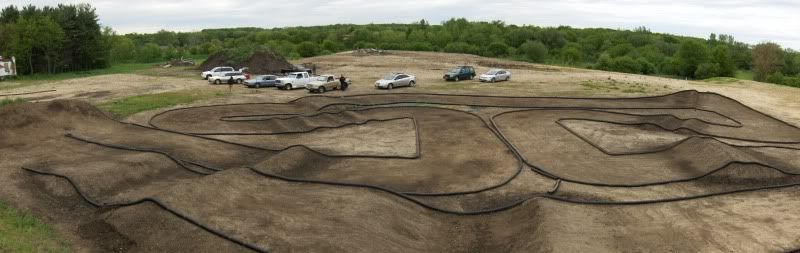

Originally Posted by Benny 13 View Post
gonna be using my mmp and ballastic 4.5 for a large outdoor track.
Think ill try to use the stock tires. i noticed that using 4 subcultures last season on my slash 4x4 was TOO much traction on our dirt. If not ill switch to proline calibers
that Spektrum S6040 looks perfect, ive got a ace ds1313 ill be trying
That track looks sweet!
