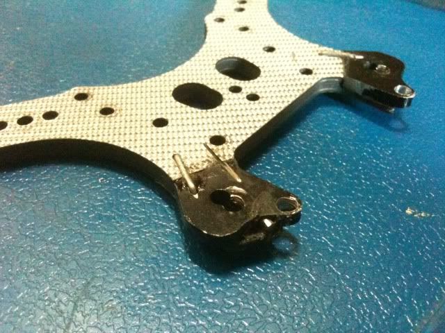

i have broken a 4mm Xtreme carbon rear shock tower! i have also bent a 4mm 6061 aluminum truggy shock tower! and yes, i have mangled the stock rear shock tower badly that you could bend that wimpy thing with your hands. oh...and this was on the losi scte.
on the 4mm carbon tower, it was the 2 lower ears holding the screws which broke, where the 2 screws holding it to the casing were...apart from that, since the 2 upper screws on the upper holes were still intact, the 2 ears on the upper part of the diff case holding the tower broke.
i broke the carbon tower on the first 30 minutes of its running life, it was a disaster actually. so i made a hybrid of my shock tower instead...
and this is how i installed it...with more support.
notice the 2 upper ears holding the tower to the case? they broke as well...no parts available so i had to do something about it... i actually find it stronger than the stock ones, hehe. and yes, i also did some things with my rear bumper....my kit is actually now a "frankenstein", with parts transplanted from other brand of kits. haha sure it looks messy but heck it does its job very well. and that's all i care for now...to finish the race.

I have broken a rear losi 8ight shock tower in the lower area as you broke your graphite.. This type of break is typically due to screws backing out that hold the lower shock tower in place. Once they back out, snap in no time.
the fix... Always check your screws over good before use or between races. It's virtually impossible to break them in that area with out a retarded head on into a concrete wall or metal pole
ps the integy carbon towers are the beefiest of all on the market for the scte that i've seen.
I highlighted on bold the problem. Not all carbon fiber is the same. Different manufacturers use different thread count and quality cf fabric not to mention the different hardeners and epoxies used. I'm yet to hear of ANYONE break the Losi cf shock tower, i'm not saying it hasnt happened, but i'm yet to hear of it. I really want to give u a big thumbs up on ur ingenuity of ur ideas tho. I'd love to see some pix and have more info on the 1/8 scale diffs, options are always a good thing. But i run a MMM 2650 on 3s on this thing and have run 4s just for fun and its drivetrain is plenty capable of handling the power, especially once the lightened outdrives become available.
