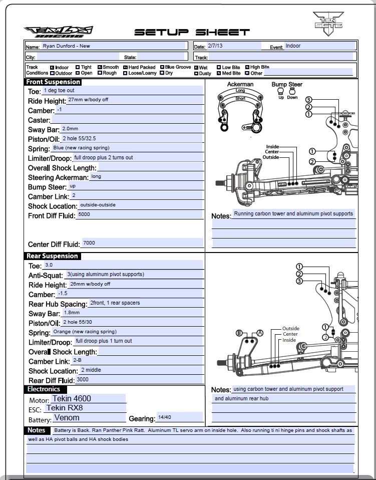

Originally Posted by hacker07 View Post
I have attached the most recent and final SCTE 1.0 setup.
Took me an hour to find, but it was in this post.
For the record, the 2.0 truck has different front and rear towers, so different rear camber positions. Also a different chassis/motor position, so weight transfer is different.

Originally Posted by sp0097 View Post
http://www.casper-rc.com/images/TEN_..._13_reduce.pdf
CasperRc has his setup for 2.0, which I understand is very similar to the 1.0 setup.
The original 2.0 setup is basically where we left off with the 1.0 and started the 2.0 setup wise.
