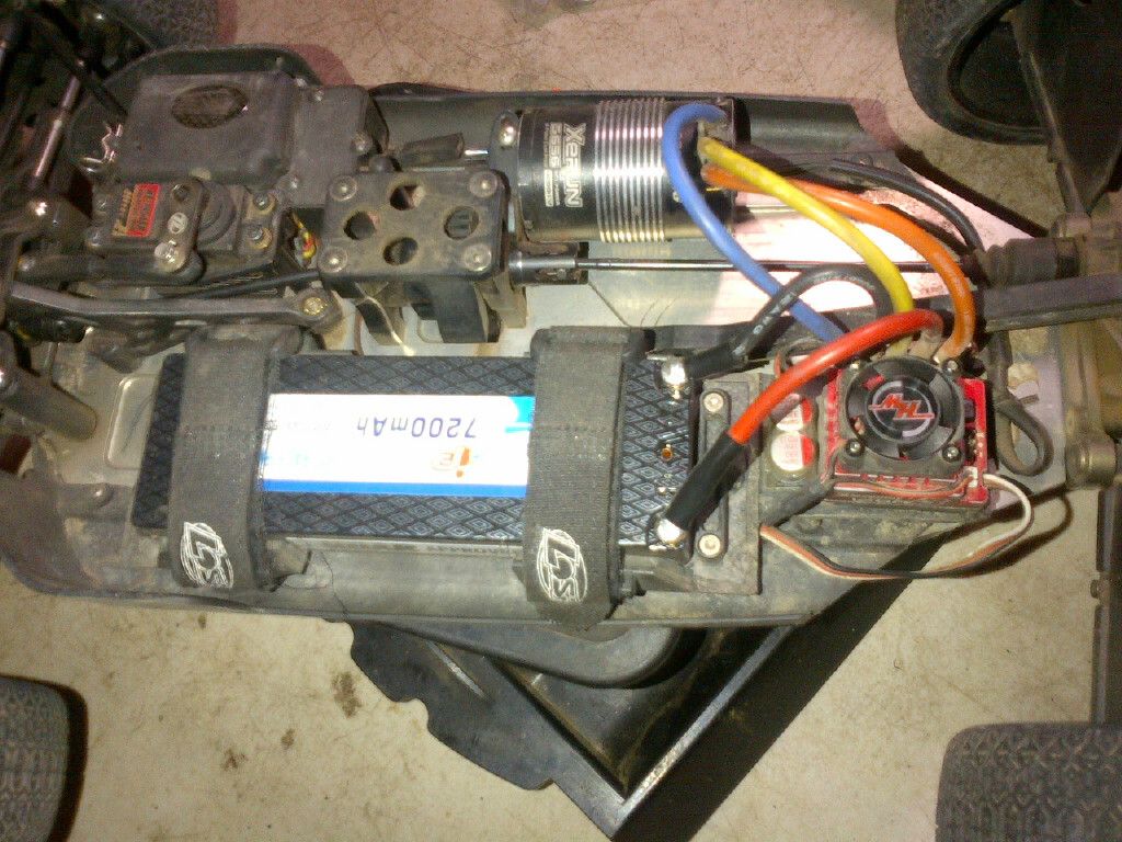

has anyone had trouble with there nano tech doing this at the pos terminal
Can you post a pic of the connector on the esc that plugged into that battery?
That would be what happens when your plugs are too loose.. the heat build up from the arc'ing is what caused it to melt off like that and destroy the pack. NEVER have loose plugs, they should always be tough to get in and out.
PS that wire job really needs work.. make a run with 4mm bullets right off the ESC into the bullets on the pack, do not run to a deans then to the bullets. Why in gods name are you running a BEC? The only esc that needs a bec is the castle mmp.. at least that I'm aware of. Certainly the rx8 does not need it.
These wires may even be a little long to some, and those solder joints look a little weak; bad solder joints will make for heat issues or worse. (ps mine are 5mm plugs on the new ip packs, but for most, including nanotechs, 4mm is the right size.

the way i got it setup the total lenth of the batt wire to esc is 11 1/2 inches i have castle bec tekin rx8 pro4600 savox 1258 maybe i should shorten the lenth from the esc to the batt
not even with a savox 1258 servo? i thought most people with savox servo were running bec?
Those are the "birdcage" style bullets (I'm guessing you used those that come with the battery). Better stick with solid/split bullets such as Castle Creations or Duratrax:
