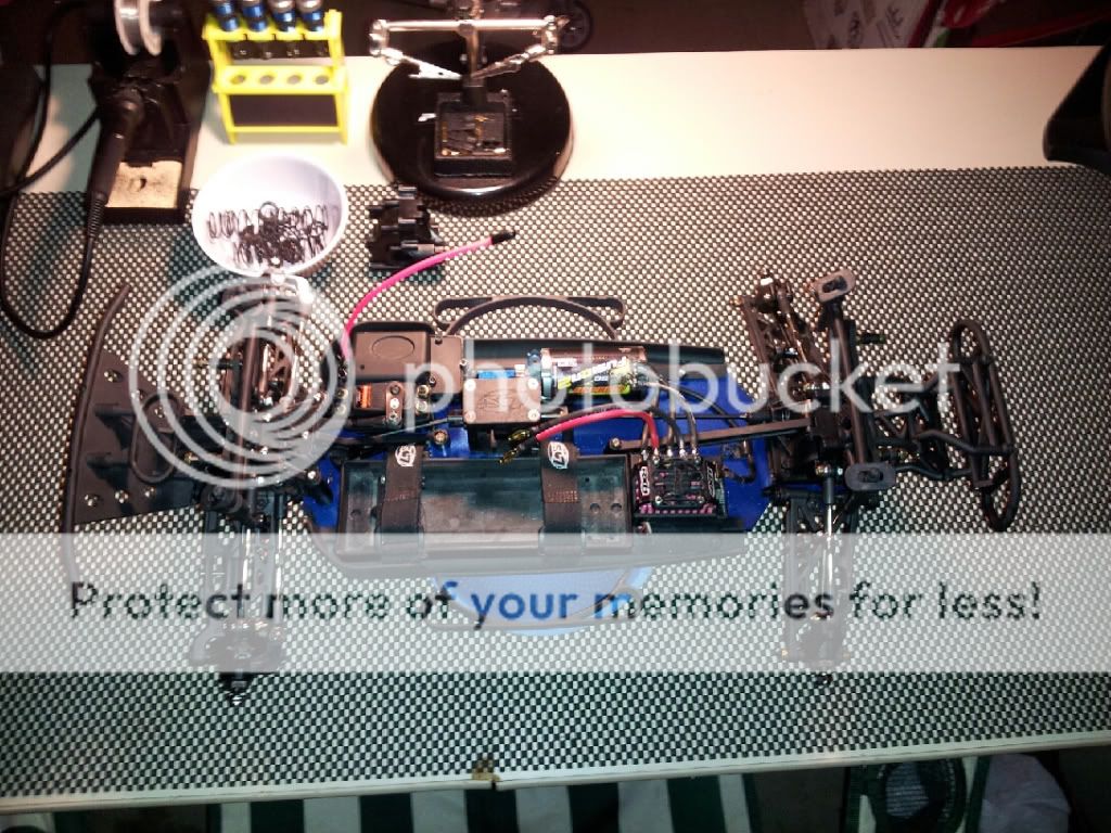

Here's my truck , she's alive. I can't wait to try it out.
Didn't build it with MIP bypass yet, want to try out stock shocks first.

Put that on the track, Pull the trigger and be ready to smile big time! Even without the bypass done you'll still be blown away compared to brand AE.
