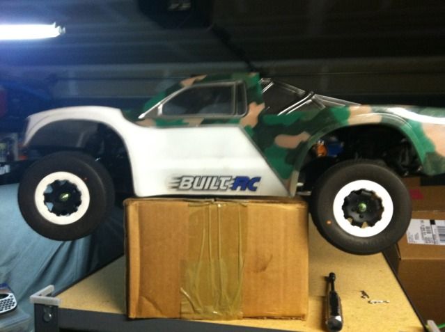

dish wheels on an SC? no thanks. i like this better (22SCT wheels with white beadlock rings):

That looks sick Phreak!!

Thanks buddy!
