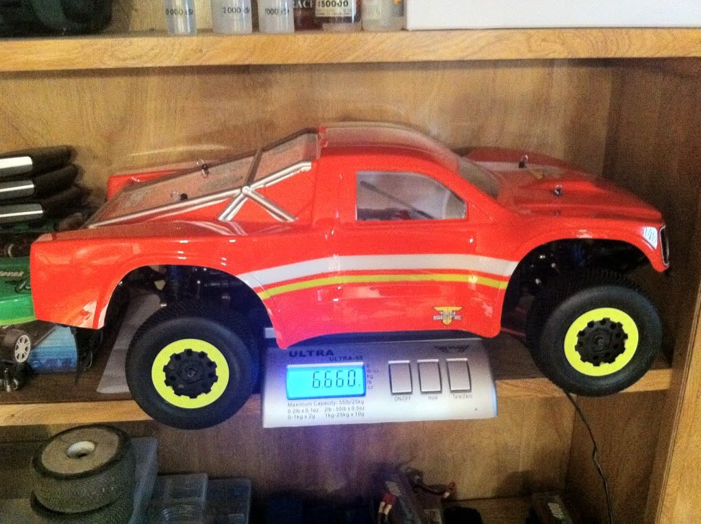

Mine weighs in at 6.66lbs ready to race with TP 5300 40c pack. Slightly heavier with my 6200mah pack. This is with the CF towers, aluminum toe blocks, the MMP and 1410 motor. This is about 1/2 lb heavier than my jammin was. (jammin was just a smidge over 6lb RTR) I had mine modified quite a bit and it is actually a little lighter than a stock jammin. This doesnt sound like alot, but I think that even at 6lbs we are really pushing the limits on the 2s batteries and once you start crossing that line the extra half lb starts to become more noticeable.
Had the first race weekend with it this weekend and after a 2 day race these are my observations....
Coming from my Jammin it does feel on the heavy side and a bit slower reacting on both the turning and the acceleration. On the plus side it takes off from jumps flatter and MUCH more consistently, and also lands the jumps better. (Lands the jumps about the same as my jammin with 1/8 big bores on it). Durability seems to be better, but really will need more than one race weekend to get a true gauge of long term durability. There were a couple weak parts on the jammin that needed addressing, but once that happened it actually held up very well and the parts wear was very good. Diffs and drive train on it were VERY solid. After seeing the extreme wear in the difs and on the outdrives in my losi 810e after only about 4-5 race days, I am a little concerned about them on the SCTE since its the same parts and an even heavier truck.
There were a bunch of the new SCTEs at the track this weekend. I used used the setup sheet that Ryan posted and I basically got my but kicked by all the guys running the box stock cars with grease in the diffs and all!!! I did try to make adjustments as I went, but didn't really make alot of significant progress. Don't get me wrong, It still ran well. I qualified 6th in the A main out of 20 trucks so not bad at all, and finished 5th in the main. It was just frustrating to hear the 3 losi's that were ahead of me saying that they hadn't bothered changing anything and they were beating me LOL. I think 4 of the top 6 trucks were SCTEs and there was a Durango and a Jammin mixed in.
Now that I have gotten a bit of a feel for the truck, I personally plan to shed as much weight as possible on this car. Modifications I am planning to make to start are:
  • Ditch the mud guards and nerf bars. Maybe keep the first couple inches of mud guard at the front of the chassis just to deflect a little dirt from the front wheels.
  • Ditch the battery tray and esc mount. Plan is to mount the hard case pack flat on the chassis with velcro and a single strap front to back (like the old gorillamax chassis straps). Mount the esc flat on the chassis.
  • Ditch the RX box and use some tekno servo mounts to mount the steering servo.
  • Ditch the oversize center dif top plate and the bottom plate/hole plugs for the chassis.
  • Probably switch out the motor mount to the RC-monster TEN-T mount as well to save a little weight over the 2 piece setup.
  • Titanium turnbuckles.
I think just removing all of the unnecessary parts will get this down close to the weight of my jammin and hopefully make it feel a little more nimble.
Oh yea... In the stock mounting position it looks like the body is mounted alot higher than it needs to be. It seems that the only thing that is forcing the body to be mounted that high is the front wheels rubbing on the wheel well when the wheels are turned. I am going to trim the hell out of the front wheel wells and see if I can lower the body. From what it looks like on first inspection it appears to be almost a half inch higher than necessary. Will have to look at this closer though, I'm afraid trimming this up to far will weaken the body in the front. Lowering that big SC body should also help with how quick it feels in the turns.
All in all I think this will be a good truck. Like almost every new car I have ever bought it will just take doing the work to get it dialed in the way I want it.

Hey jhautz just thought I'd let you know the RCM mount weighs a little more than the Losi. RCM 2.05oz/58g Losi 1.05oz/43g.

Those mods are what I talked about last week.. I'm on the same page man.. thinking about a diet from the get go. MMp is going on the top center diff mount, I plan on hacking up the rx/servo mount or making a custom mount, a type of direct mount for my batteries as well. I'm thinking about going with two o-rings loosely based off of the mount in the CRC 1/12 carpet cars. I was plannng on loosing the mud guards, but wasn't sure about those center parts... who knows. I'll keep the losi motor mount though but the rest is up in the air.

My trucks a fat ho and needs to go on a diet... 6lbs 11oz. But I do have a few parts that are not stock and do weigh more. You will be able to shave a ton of weight just by your list. I don't mind mine heavy, I've gotten used to it now.
Funny you mentioned the grease in the gears, I drove the truck one weekend with the grease then changed it out. I actually liked the way it drove with the grease lol. Running 5-7-3 now and seems great...
