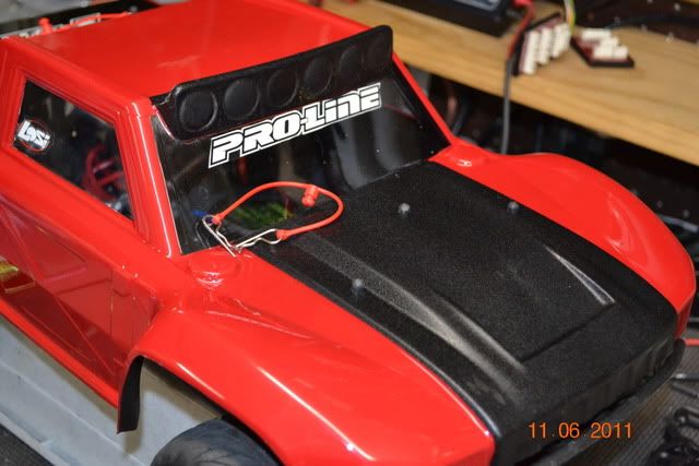

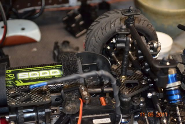

We goop and re-regoop. I rececently added a 3rd front center body post that seems like a promising solution to slowing down the cracking in the front behind the fenders that happens in just about all bodies eventually. Need a few more runs to really decide how it will work.

Here is the center post I added. I can't claim to be the originator of the idea. It was posted on this thread awhile back. It eliminates most of the flex that occurs in that area of the body. I've run it in one race session and it held up well. I think its in old T-Maxx body post (not sure, came from parts bin) and a Losi 810 front body mount.
