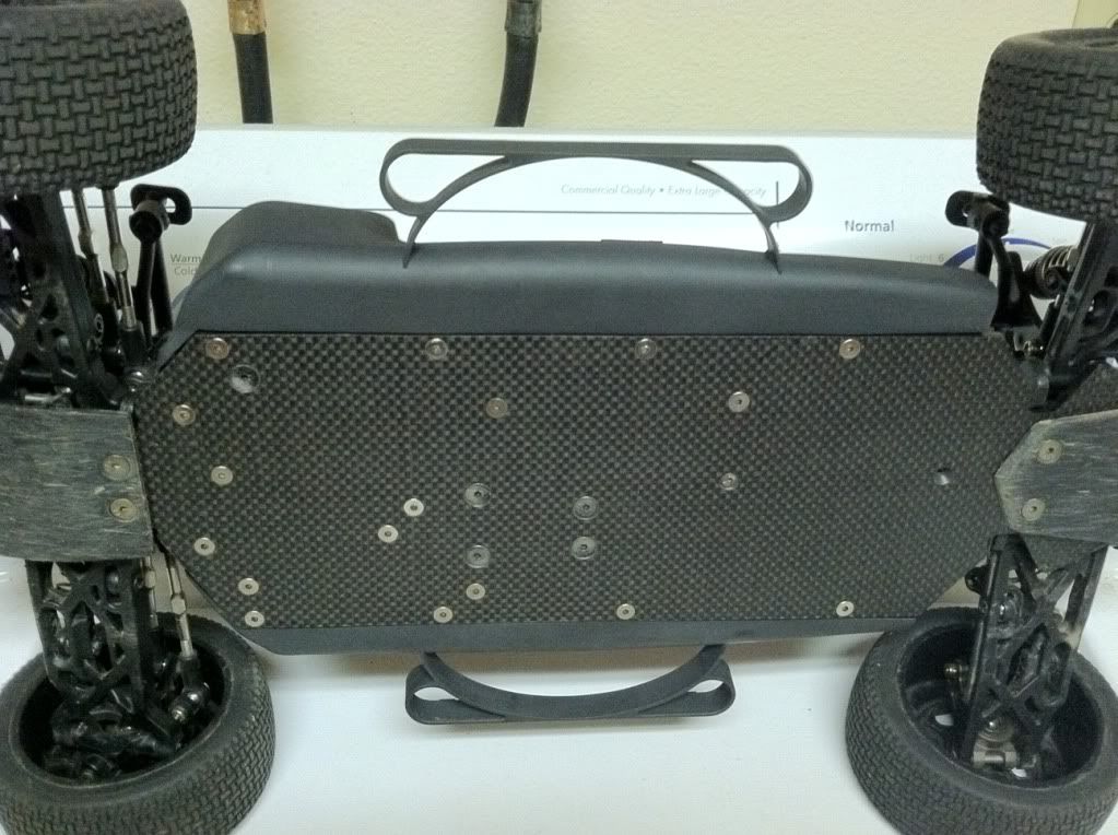

Just got the SNR CF chassis. Perfect fit. Very high quality. Can't wait to run it at the track.

Looks awesome! If you find your truck pushes more with the stiffer chassis, try going back to the original rear chassis brace, that'll probably bring a little more flex to the rear end of the truck which may give you better steering. That being said, I don't think it'll be an issue since the geometry of this truck seems to have a lot of steering built into it in the first place. I'm getting mine tomorrow. I'm getting the 3.7mm, good luck with yours! Let us know how you like it!

Thanks for the advice. I totally forgot about the stock shorter chassis brace. Will try both tomorrow at the track.

I dont Like you anymore! JK! Looks nice!

I'd have to get a chassis protector for that thing.
Looks good though.
