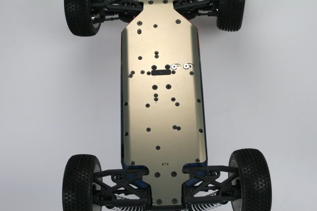

The layout looks cool but the items listed above will be annoying, especially that junky motor mount. It is kind of a cross between a Tekno mount and a Rc-Monster mount but it will not work like either one. If they want to mount the motor separate from the center diff bulkheads, they need 4 screws like the Tekno. If they want to make it like an RC-Monster mount, they need to connect it to the center bulkhead. What they have may work is they also made a diff top plate that was connected to the motor mount with slots just like the slots in the chassis. 1/8th motors are too heavy to be supported on one end with two little screws in a 3mm chassis.
I agree with all your comments!!!! But, with the changes made....this buggy still should be awesome!

Yo Steve..... what do you think of the motor mount though....? Do you think it'll be ok, or do you think an aftermarket part will be the way to go. I agree that the design as of now MAY be a little weak?! Also, do you think any other bodies will fit? What about your Losi body for your Hyper 9E.......The NEXX8 body is ok, I just like to have options!

Ofna Team drivers have had hundreds of hours on this car with the stock motor mount with no problems what so ever.
