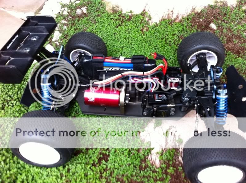

Here is what I have so far. Please let me know if you see anything I did wrong and should change as this is my first electric kit. I know the servo is crap but the one I ordered won't be here till Monday and I want to test it out tomorrow. All input is very much appreciated.
Rear Diff 2000wt
Center Diff 5000wt
Front Diff 5000wt
14t pinion
2s 5000 40c
CC SW 3800
Attached Thumbnails Hyper TT 4wd 1/10th Truggy Thread-p1016504.jpg   Hyper TT 4wd 1/10th Truggy Thread-p1016503.jpg   Hyper TT 4wd 1/10th Truggy Thread-p1016502.jpg

I don't think your body will fit well with the esc in the back like that. I would put it on top of the servo and the rx in front of the battery tray. It's a fun kit!

The body dropped right on. I tried putting the esc on the servo but it would'nt fit with the fan on it. When my new dremmel shows up i'm gonna grind down the sides of the fan so it sits closer to the esc then i'm gonna move it to the servo. It will probably stay cooler up front. Thank you for your reply.

If the body fits then run it! See what you need to adjust after some laps.

Looks good to me. Are you going to race? 3800kv might be a little slow with a 14t pinion. But it all depends what you want it for. For a tight technical track that'll be okay.
-Tony
Yeah I will be racing and the track is really tight and technical.

My brother use to run the CC SW 3800 with 14t and that works just fine.
He did not even have a fan on the esc..
ps71 is offline
