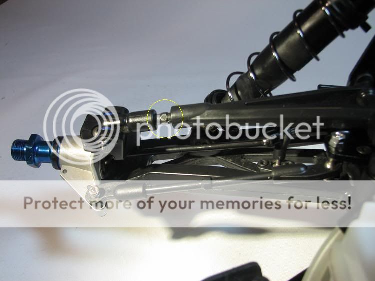

So you mean the area inside the circle, that turnbucle is adjusted as short as possible and you still have positive camber. Tires leaning out.
I didn't know you could do that with an Ae car? Can you move the link to another hole? Sounds like incorrect assembly. AE has thier manuals online you can download to see if something is installed wrong.

Yes, the tie rod you circled in your picture is shorter on mine than it is in your pic. The upper arm is connected to the INNER hole in the hub though as opposed to your picture where it is connected to the outer hole. I tried connecting to the outer hole, but I couldn't lean the hub inward far enough as it hits the lower arm and doesn't let me lean it inward further.
I have the manual and compared it to what the manual says and it looks to be correct. The manual even shows using the inner hole in the hub. I'll try to look again to see if everything's correct, but more ideas/suggestions are appreciated in the meantime.

let me add.. the manual for the RC8 says to have them at 7mm, but i had to crank them down to 6.4mm to get the camber i wanted (on my buggy). the problem gets to be the nut on the camber rods ends up with such little clearance between the rod and the upper arm.
what's your positive camber now ?
i say crank 'em down to what you need.

Ok figured it out. It was assembled correctly per the manual. Lesson though: DON'T FOLLOW THE MANUAL....HAHA. The A-arm hub link needs to be connected to the outer hole per the pic posted, not the inner hole per the instructions. And in order for the hub to lean far enough to reach the outer hole, the suspension must be partly compressed or else the hub will hit the lower arm. Now I have lots of negative camber and need to dial some out. Thanks for the help guys.
