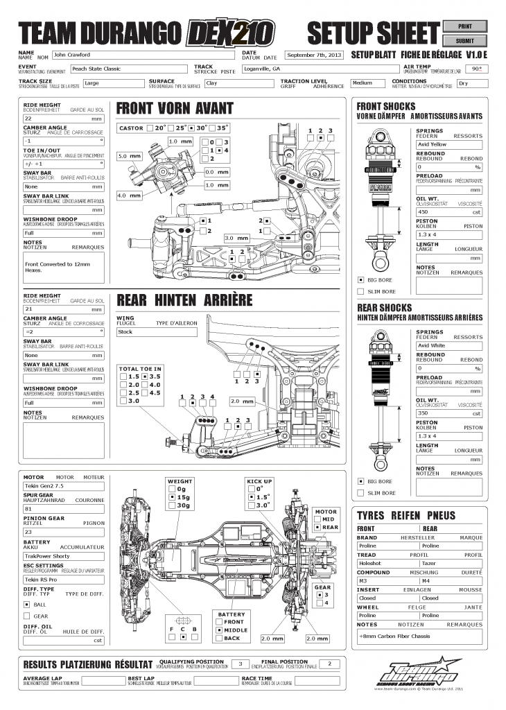

Here is my latest setup for a large outdoor clay track with low to medium traction. Car was very easy to drive.
