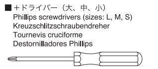

What type of Phillips head screws are used? Is it a normal P2 or a JIS tip screwdriver? I want to buy the correct screwdriver for when I finally get the buggy. Thanks

the manual specifies Phillips not Japanese industry Standard,

It's more likely they are a P2. There might be some tinny screws that will require a P1, but I'm not sure.
