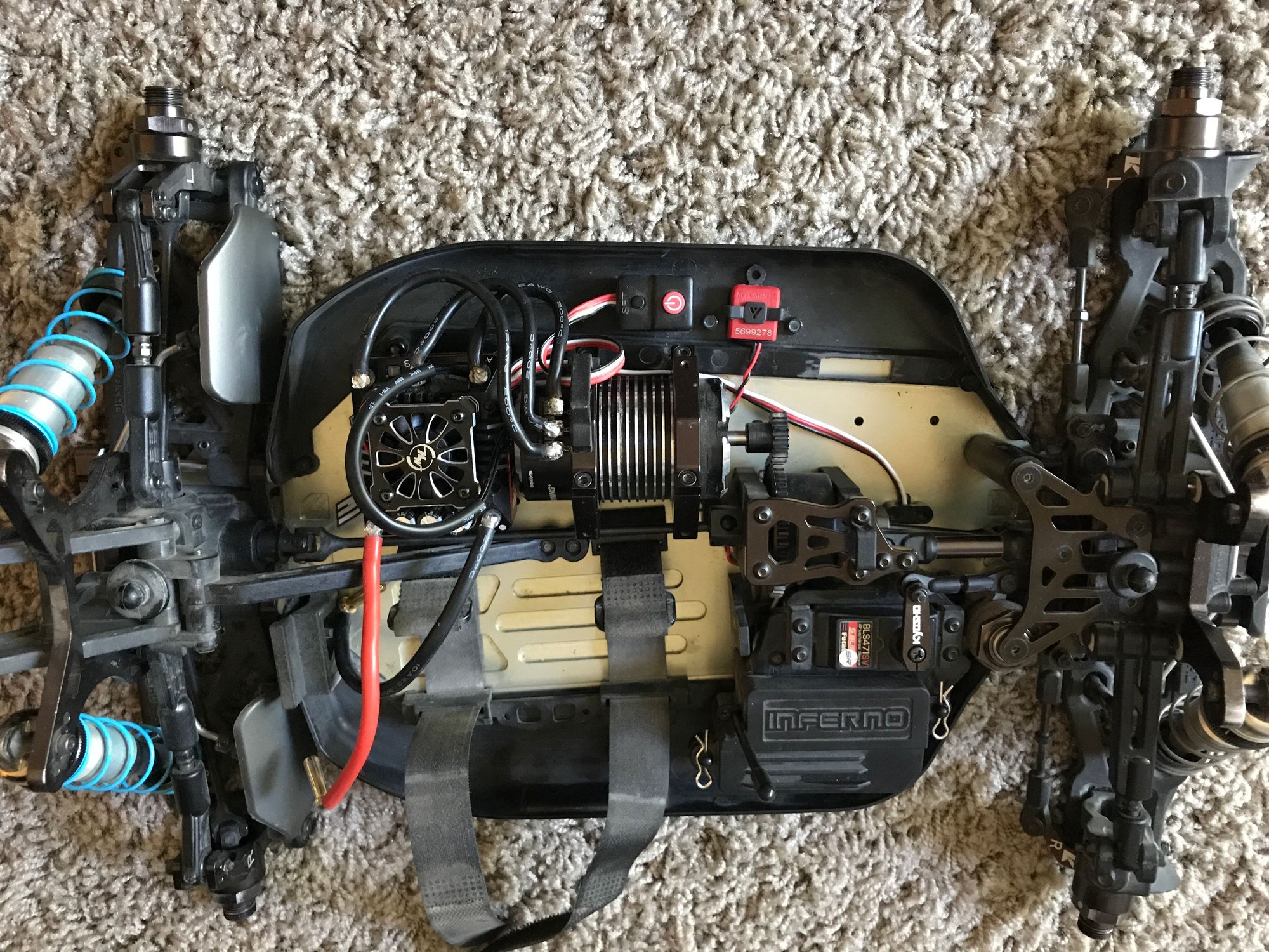

Hi, if you are running this car I think you should try this layout. I think it works better on certain track conditions. If the track is technical and blown out I feel breaking works better with this one, since it does not dive to ruts as easily. This is how the RTR mp9e is assembled by the way from the factory. If you have tried this please let us know how you felt about it ?
Cheers
Cheers
I just reconfigured my car too. Willing to give it a try to see how it handles.
When viewing it, I like the way the motor/esc balances the battery pack.
Question for you. What have you done to the rear motor mount? It appears as if it is doubled up some how?

Posts: 1,636
great
yes in this pic its still doubled but not anymore since I did the wiring again (that was left from my clutch testing sorry)
now it's all stock
