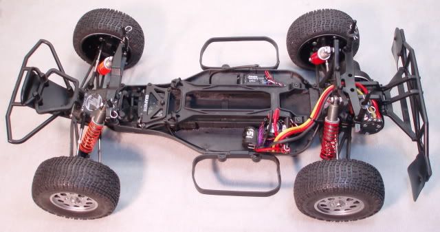

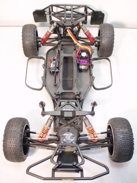

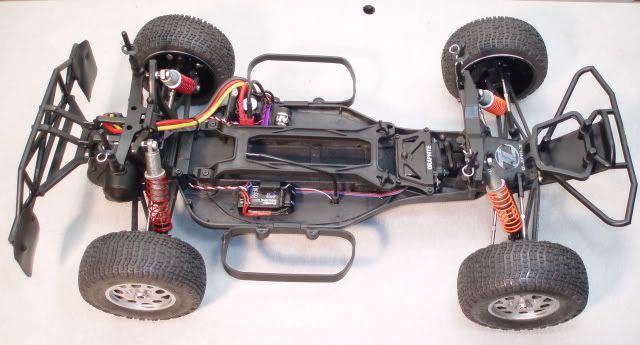

Well I know it's been a long time putting this thing together, but I got one step closer, I got all the electronics in it, check it out. All I have to do now is program the lipo cut off that I had to install, and setup a model in my radio, and I should be ready to take it out on it's maiden voyage.

LOOKS AWSOME CHROME.....

chrome that thing really does look good.
