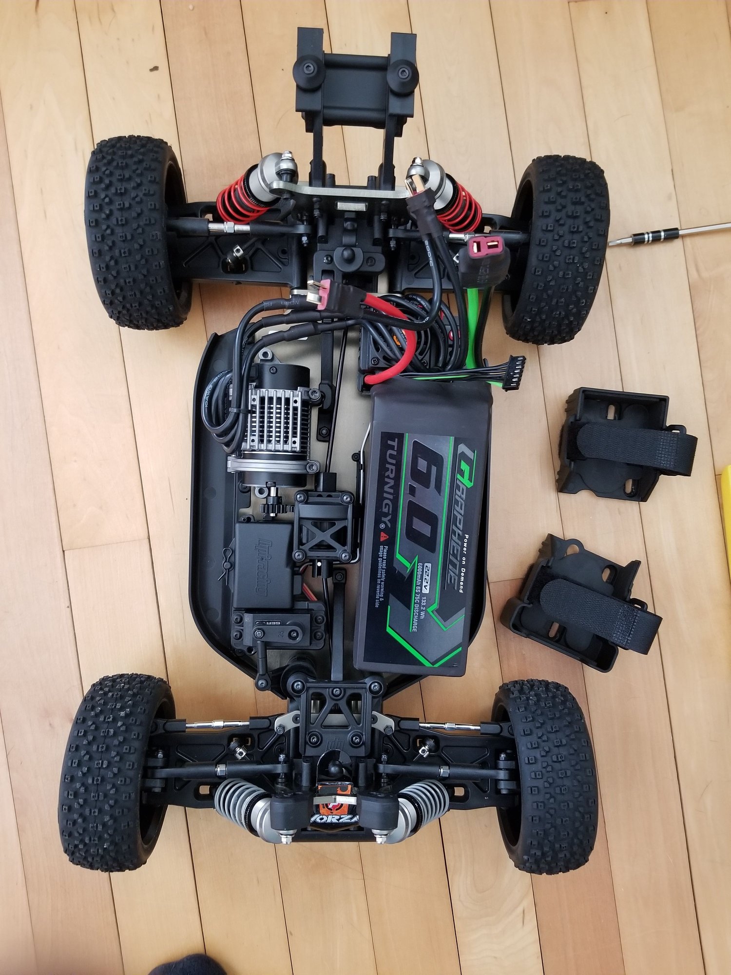

Hello there!
I just got my first RC car, the legendary Vorza! I already have an issue It is my fault, I just followed someones post telling them to get this battery and that it will probably fit. I would like to make them work because I have 2 of them and I don't know anyone that would buy them. I am unsure if I can return them but I would rather just figure out how to make it work.
SO.. how do I make this fit? It fits with no tray if I force it in. I think I will have to move that ESC out of the way, or position it so I gain a tiny bit of room. I will also have to cut a couple of sides off the battery tray, maybe even 3 sides. Not sure how weak that will make the final side holding the straps. I also plan on using velcro on the bottom of the tray and battery to help keep it from moving.
Please share your ideas and thank you!
Destructionist is offline

I think I got it!
I cut out some of the trays sides, I left the part close to the drive shaft, and the front side, i removed the sides by the edge of the car and the one in the back to make room. I took out the ESC and its plate, I removed the ESC from the plate and drilled holes in it to mount it over the diff, I took out 2 diff screws out and mounted the plate with 2 longer screws ontop of the diff. I am not sure if I should have used the 4 screws... Anyway, I put velcro on the bottom of the tray and the battery and strapped it in tight. The ESC went over the plate with the sticky pad it came with, and I added a zip tie for extra measure. I ziptied the motor wires to the cable management thing to make sure they don't go anywhere, and i have double sided velcro that i looped around the battery to hold on to the wires.
Here is what I got now. Please advise me about the 2 screws if you can, and any red flags you may see. This is my first RC and I think I just graduated MacGyver school.

Wow, i was looking at the bags of spare parts then looked at the price, he is asking for too much but it got me thinking if I can find some cheaper used ones that come with parts! I wonder if he did mount his ESC on that carbon fiber plate. The body won't sit right all the way up front there, it would have to be right on top of the diff or further to the back. I wanted to offset mine to one side a bit to help balance weight and I couldn't it would rub against the body. It really has to be close to the center to fit right. I am starting to think that I should have mounted the plate with 4 screws rather than 2 on opposing corners but it feels sturdy for now.
I am dying to play with it outside but we had a snow storm recently and everything is covered. I don't want to put it through snow yet. I turned punch control down to the slowest setting to save my hardwood while I try to race around my house
I have a 44 inch spur and a 20 tooth pinion I want to put on soon once I play with factory teeth and get a good feel for the machine. I also already hate the controller and I want a new one.

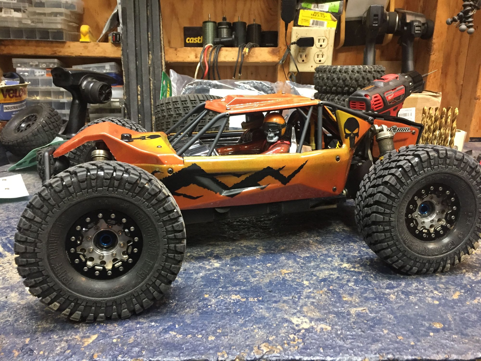

That’s what I do...I hunt for cheap rollers and pats lots on eBay for spares and projects. This is a build I made from a HB D8 roller that I picked up on eBay a few months ago. All these parts on this build are compatible with a Vorza ...
i cut a piece of Kydex to use for an esc mount, much like that eBay listing....In order to make this body fit
chainsaw10 is offline

Thatís what I do...I hunt for cheap rollers and pats lots on eBay for spares and projects. This is a build I made from a HB D8 roller that I picked up on eBay a few months ago. All these parts on this build are compatible with a Vorza ...
There is a lot more room to place stuff with a new body! I had to place the ESC where it is to clear the body! I would like to have had it more to the side to offset the weight of my massive battery. I am waiting on worrying about balance till I get all my parts in. A new better servo will probably weigh more, so will the 20 tooth pinion when it goes on. I will install the castle creations pro bec behind the motor, that will add weight too. I am not sure if a Spectrum SRS6000 reciever is heavier but there is that too. I am not sure if wire weight is significant, but when all the lights are installed, and the the servo arm is replaced with metal it will balance out a little more. All of these little things together will add weight when I get them then I will try to balance the car. I have seen people use car wheel balance weights to even things out. There is not much room to move thins around at all without drilling holes, one thing i really don't want to do. If it comes to it, I will change the body to put the esc somewhere better.
I also want that skyrc corner balance system! I am so poor all of a sudden...
