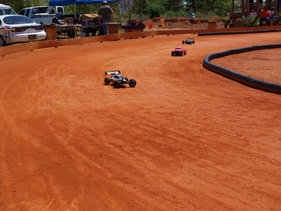

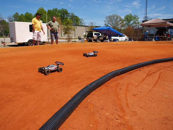

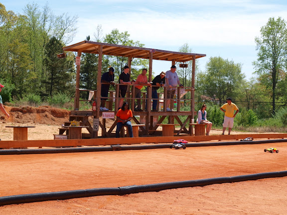

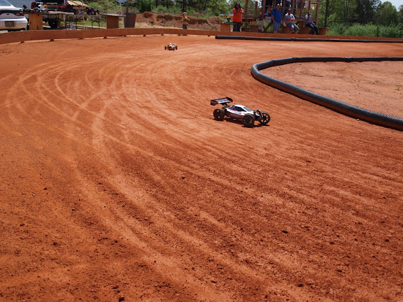

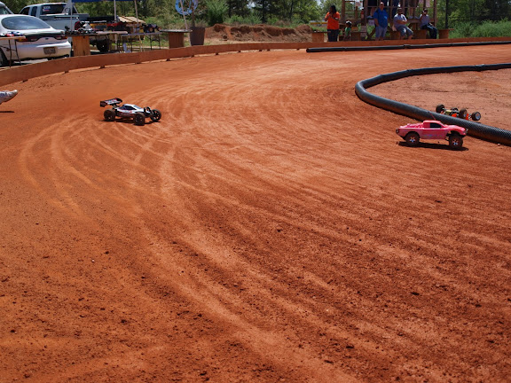

Ok, here are some pics from last weekends race....
