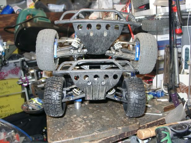

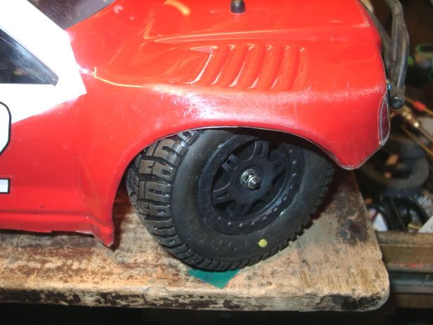

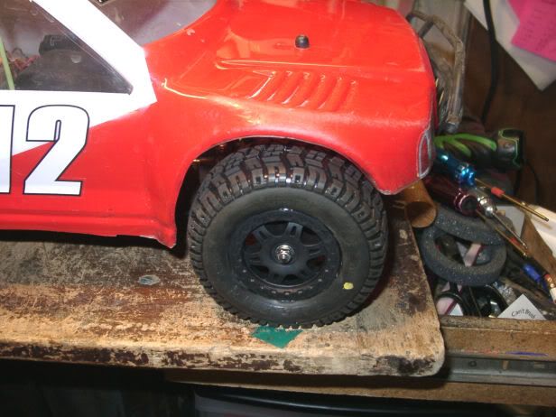

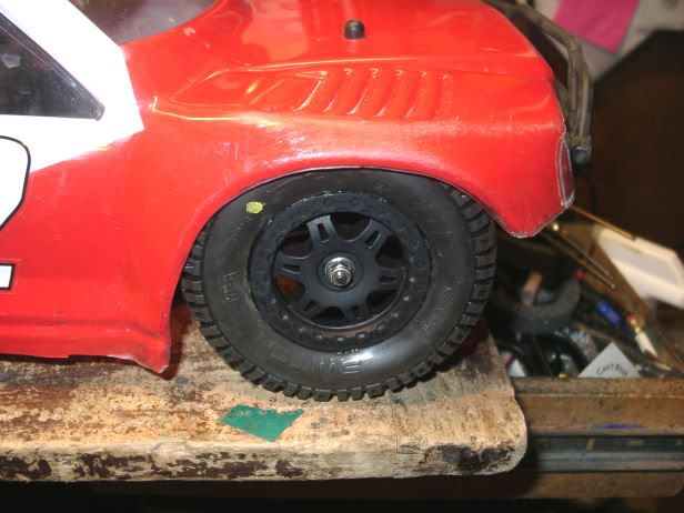

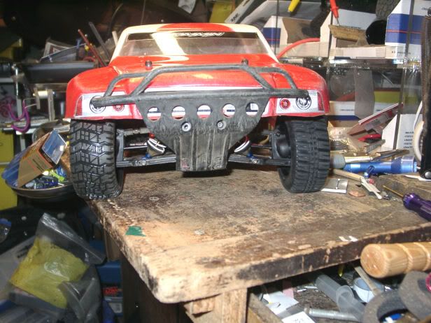

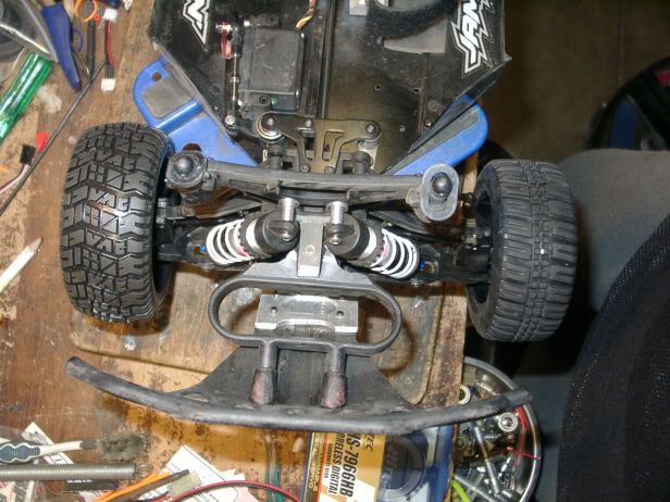

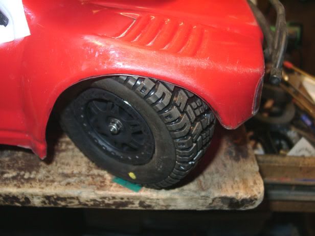

Ok I finally got a set of Proline zero offset wheels that I wanted to try out on my Jammin. Not that the stock wheels/tires are bad, I would just like a few more options regarding tread and compounds. I fitted the Prolines and they are about the same width but about 1/4" taller. I read where Chad runs his shocks higher to compensate, but since I am running modified Jato shocks I moved the shock bottoms to the outer hole and it made the truck sit about the same (ride height) and I gained most of my droop back. The tires fit perfectly inside the stock body, but they do rub slightly at the top and when the wheels are at full lock. I raised the body mount one notch and no more rubbing. One thing I did notice is the Jammin's track is much narrower than a Slash 4x4, almost an inch. This has nothing to do with the Prolines and I know the Jammin sits lower which helps, but it will be interesting to see how it handles now.
Proline on the left, stock Jammin on the right
Proline with truck at rest
Suspension fully compressed
Left full lock, suspension fully compressed
Right full lock, suspension fully compressed
Front view
Difference in widht between the Jammin and Slash 4x4 and no they are not making a Jammash 4x4.
Thats why I went with the slash rear wheels, to get some track back. I didn't want to increase it's height without increasing it's width also. Let us know how it performs...

This picture of the Jammin against the Slash really helps me to see the width difference with the O-Offset Proline Wheels.
Please do the same but change out the Prolines with Slash Rears on the Jammin.
