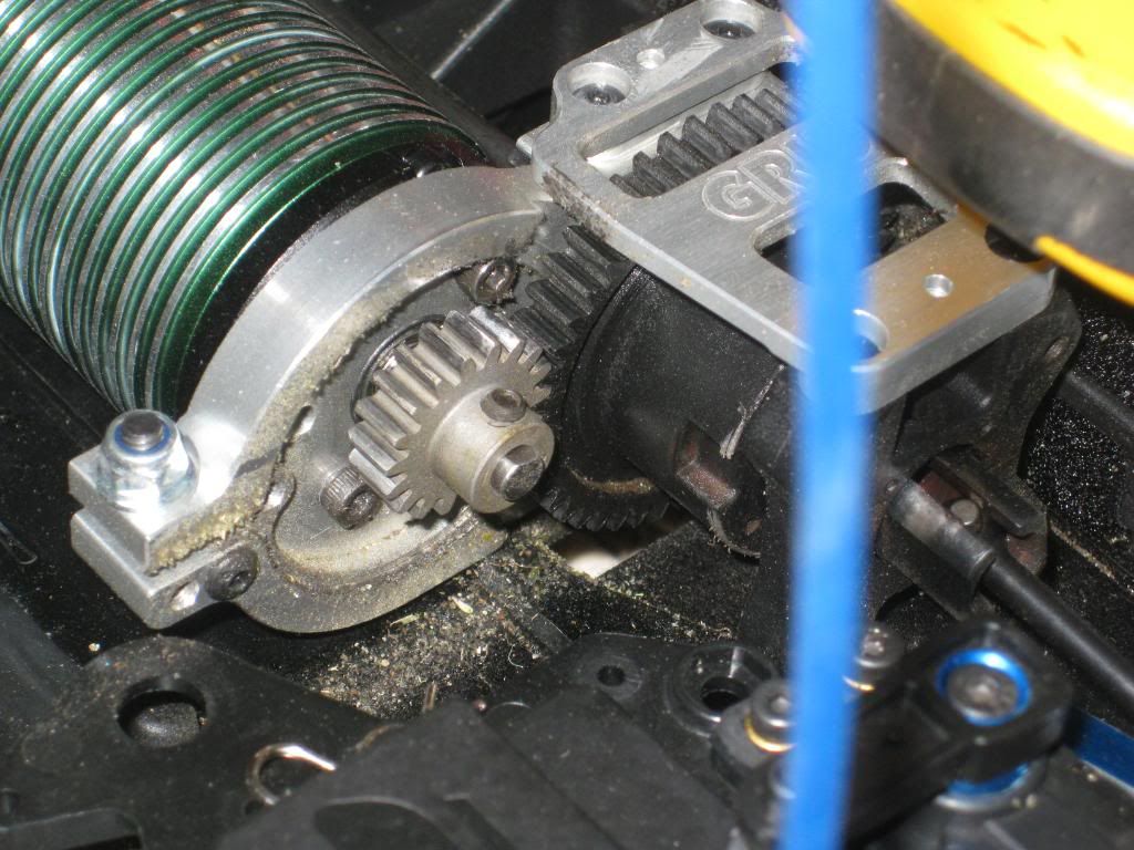

have you guys notice the motor plate that comes with the rc8t conversion kit is a pain to adjust ! espially getting the pinion to line up right .
Yup, that's why you buy a Grid RC motor mount.

thanks i will look into that .
oh dam i looked at thier website and they are located in canada i dont know man the shipping cost whould not be cheap to the usa.
I looked at the elite motor mount but its out of stock go figure.

That is really ALL of the AE conversions/Te setups... one easy way around is to pull the RX box when you line up the motor... it allows you to get a bit more of a hex driver in there to work... OR you can go with a grid or elite mount IF you can find one... I run 2 Elite mounts and 2 standard mounts and I can definately say the Elites are much easier... but also come with a cost...
