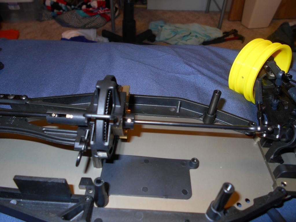

Yup, that's why I figured it'd be a drop-in fit for the front center cvd in the DEX. I didn't even bother to remove the bevel gear assembly from my spare DESC cvd, I just removed the DEX rear diff case and swapped the diffs.
After I carefully dremeled the center slipper outdrive cup I realized it would have been easier to just grind flats in the cvd pins, and would probably spread the load better into the outdrive.

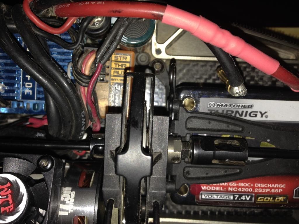

I've attached pics for clarity. Looks like my drive shafts are much shorter than the pics I've seen posted here. The durango site lists the Ujoints at 70mm and my CVDs are 68mm for the MID rear joints. Seems the front is 84mm.

@pittster: your shafts go much deeper lol Did your V3 kit come with 68mm CVD's for the center joints originally? Or were they 70mm?
Original v3 CVD in mine were 68mm but in that picture above they are the 70mm UJ shafts

Thanks Vito. Looks like your center rear shaft also sits much deeper than mine. Would make sense if they are 70mm instead of 68mm like mine is. It seems like going back to the standard slipper would also help as it seems to be longer.
I think I will upgrade the center drive shaft portion to UJoints and perhaps get the alum diff hoops to help prevent the pop out issue. It's possible some screws are loose as well so I'll go thru the car to check.
