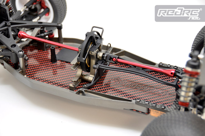

I like your choice or pictures Incubus
Me too, too bad I can't afford that stuff. LOL
When it comes to drive train, in metal the incubus trusts.
