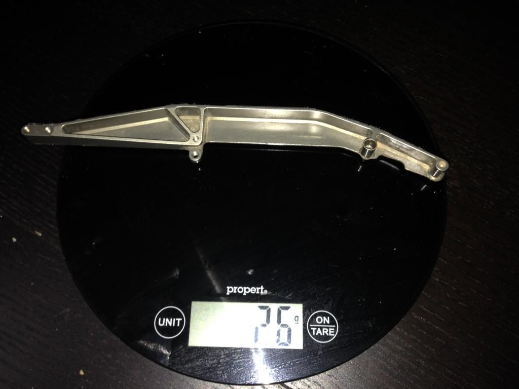

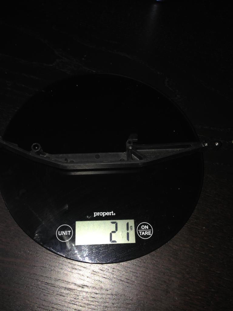

Originally Posted by Pittster
Hmm interesting I run the same chassis and everything else is the same but with alloy side pods, big bores, 30g skid weight, shorty, all 4 composite gears, shock boots,sway bars front and rear, proline bulldog body and a 30mm fan on a alloy bracket my RTR weight with hole shot 2.0 tires is 1740g
interested to hear your final RTR weight cause 1604g plus maybe 50g is still really light tempts me to loose chassis stiffness and getting plastic side pods to loose some weight.
So Having never known how much the alloy side pods weigh I grabbed a mates Dex410 plastic side pods and compared to my own.
The difference was 5g and the alloy side pod has velcro and chassis protector on it so it would be nearly the same.
