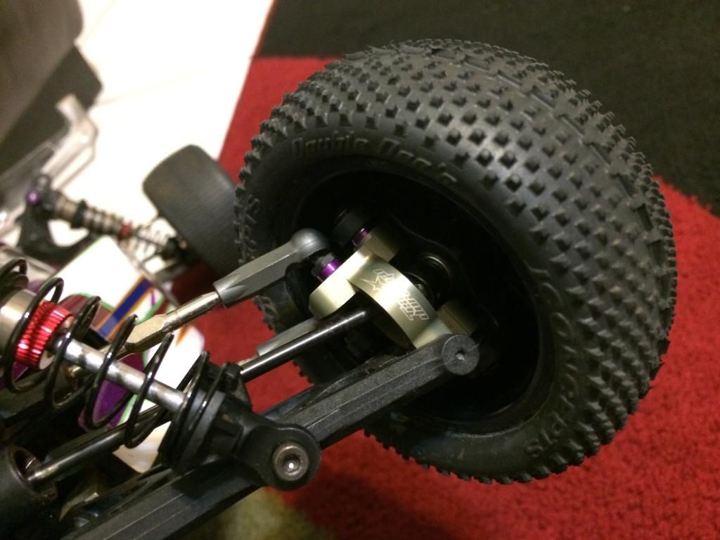

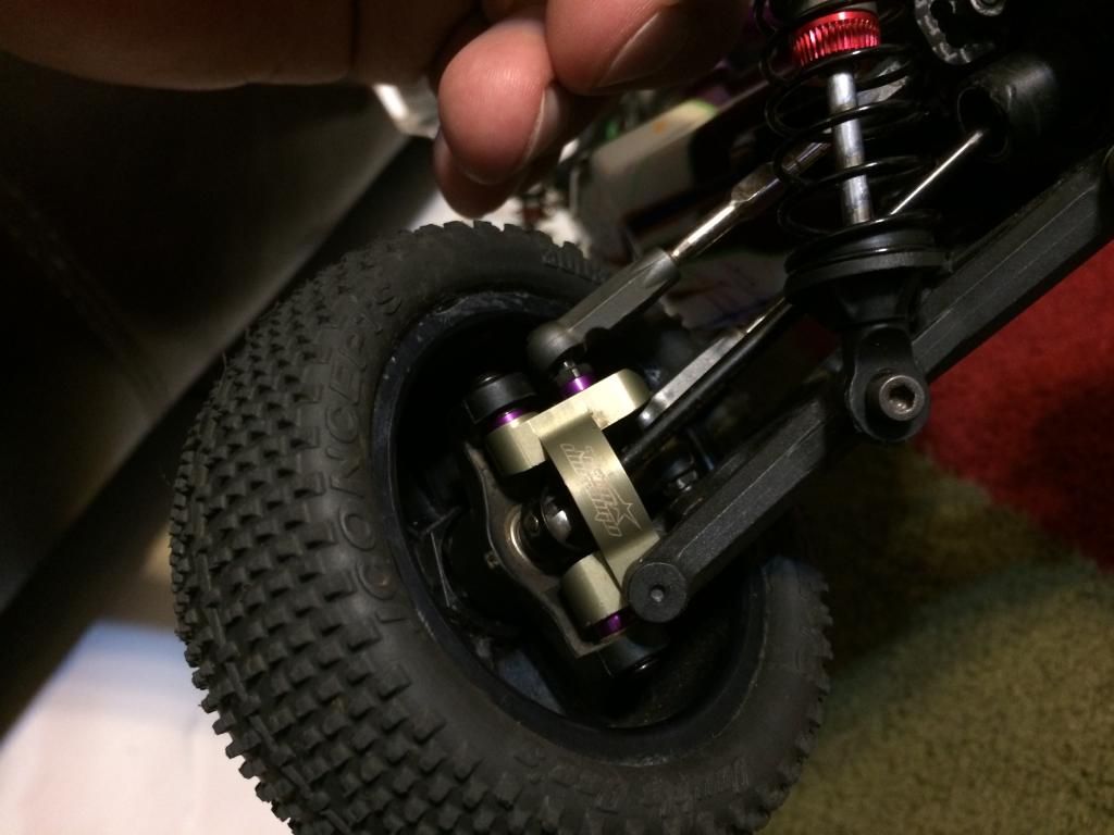

I've just noticed that at full lock my wheels will rub a bit on the ball cups. I'm using the Lunsford titanium ball studs and super duty ball cups so this may be part of the reason. I'm also running the JConcepts Inverse wheels with the 10mm hexes. So my offset could be a little different. It seems minimal and I could probably dial it out with a bit of EPA adjustment. It's smooth when I take the wheels off and I suspect it will also be smoother with the Durango wheels and 14mm hexes. With the brushless horsepower and low turns I think 14mm is better anyway. I've rounded off a few 12mm hexes.
