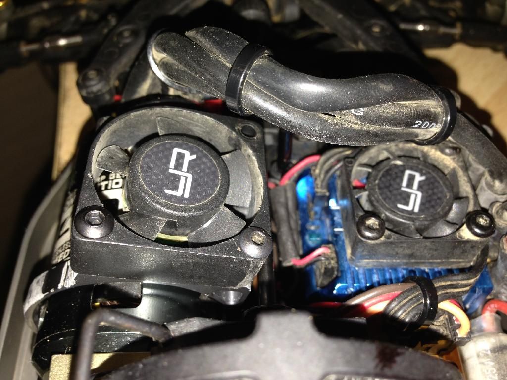

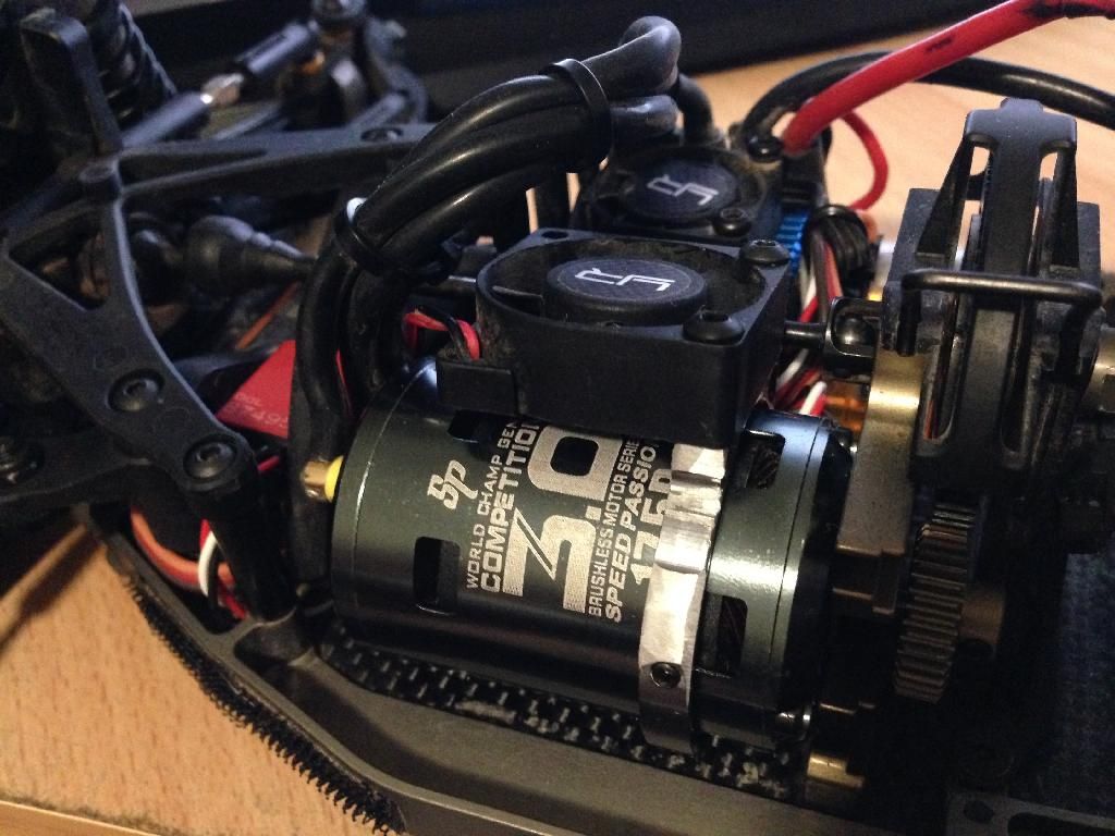

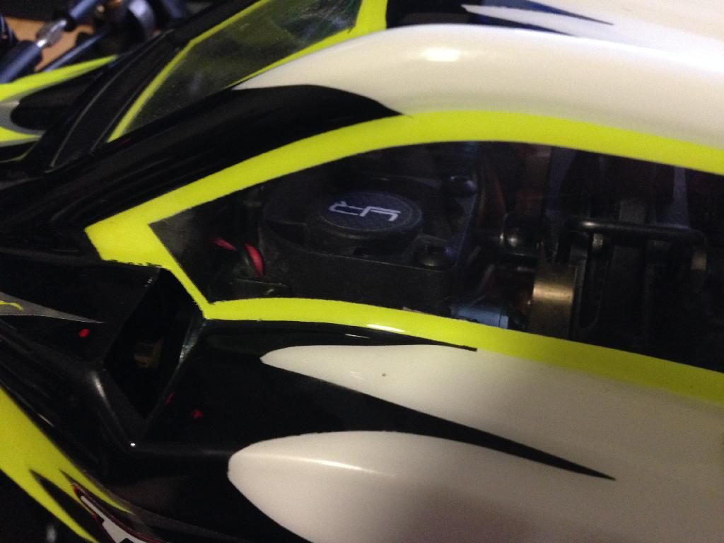

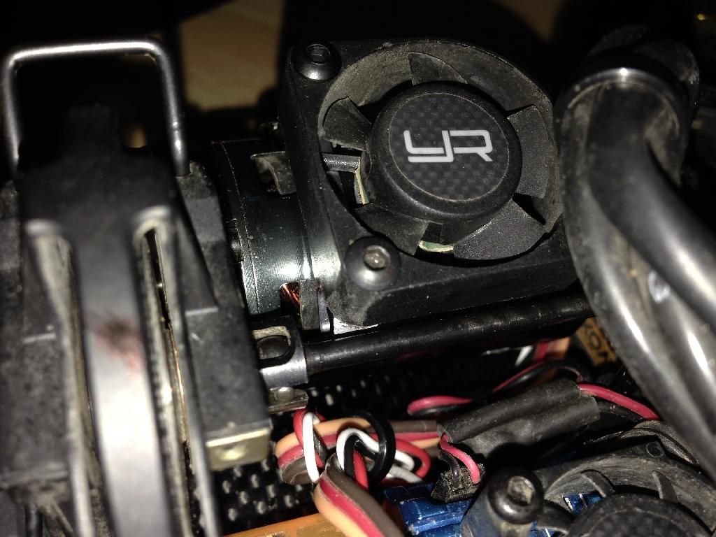

Hi all! Can anyone advice the body shell for DEX410 with more space over the motor location? Need the space to locate the colling fan.
Don't laugh We have in Ukraine the low-entry class called "standart" for the children - those class allow use the brushed motors only - 27 turns. Last time my sun was running the DEX410 with brushed HPI 27T - after 5 minutes race the motor have had F'165 degree, the rotor F'233 degree... So need at least a one fan to add.

no body will have room for a fan let alone airflow to the fan, you'll need to cut some speed holes for the fan to stick out. I also like to cut the bottom 1/4" of the windshield out and more of the back for more airflow, everything just runs cooler (do the same on mid motor cars, makes a decent drop in temps. Air needs to get in as well as out

I run a 30mm fan on my motor with a Proline bull dog body it has 0.2mm clearance from the centre shaft and 0.3mm ish from the windscreen of the shell.
I run 4wd Stock which is 17.5 Blinky so motors get hot and the ambient temps can be 30deg some race meet's so every little bit of cooling helps.
I used to cable tie the fan through my motor but then I got a yeah racing fan bracket and modified it to clear everything and do what I wanted.
Hopefully the Pics help
