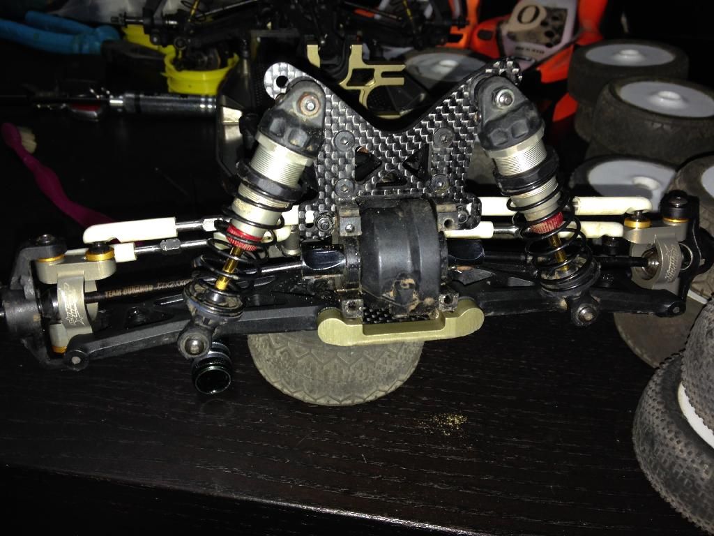

Question for the 410 veterans.
How can I tell if I have 17 Deg or 19 Deg castor blocks ?
I picked my car up second hand and it has a lot of aftermarket stuff added so I am guessing it has 19 Deg as it turns well.
It dosent have 21 written on it only the "Team Durango" which the 17 and 19 deg ones have but the colour is lighter like the 19 Deg one.
Can I measure the angle is that obvious answer?
The car is a 410 V3 which would of come with 17deg ones stock correct
Pic of my hubs
links to 17 and 19 deg pics

The 17° hubs are not marked, the 19° and 21° are clearly marked on the backside, opposite side of the team Durango logo, and cannot be mistaken for the others..

Basically all the bodies but the original from back in 2009 have similar amounts of room.
As for the color of the caster blocks, they're all hard anodized, and due to the nature of the process the result is very sensitive to the material, so batch to batch of recycled aluminum will be slightly different. I've got a very high end paintball marker all hard ano'ed and every piece is a bit different in color even though it was all anodized in the same batch (and I guess they got 1 too many complaints dispite always pointing that out so the color has been discontinued making mine very limited and rare ) Back on topic, For all those special people with v4's, is the dual slipper worth the money?
Thanks flame looks like I have 17 deg ones, I find the car steers really well with the 17's and the 21 Deg hubs will give more steering any downsides to the 21's over the 17's?
