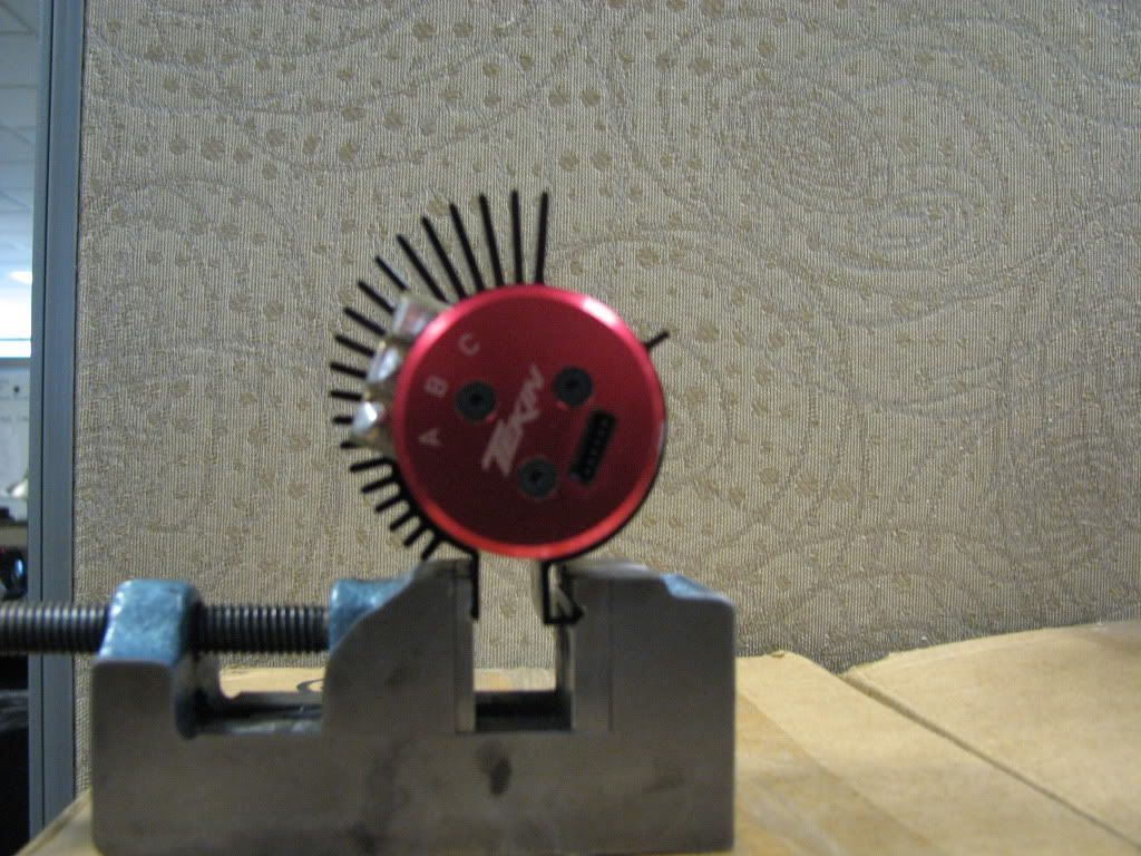

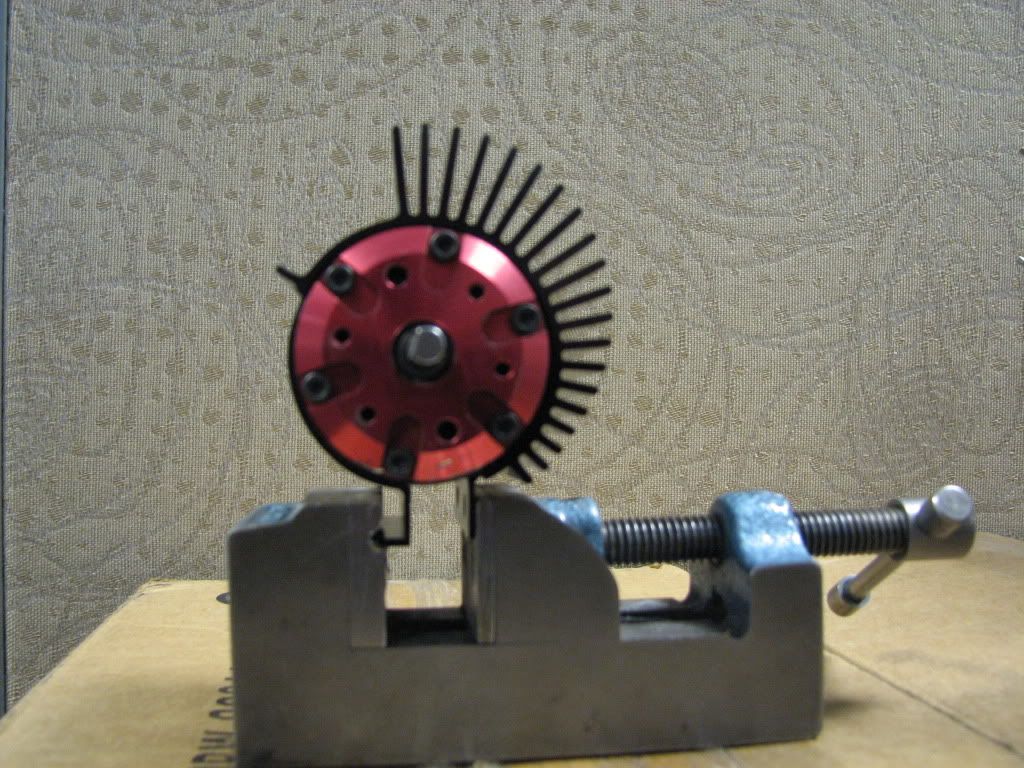

I will post a couple of pics tonight. I just know running a Tekin 1900Kv in 90+ degree heat for 15-min, geared 15/44t, is a little taxing on the motor. We typically run large outdoor tracks and noticed guys running the Tekno style chassis were running much cooler. I thought that this could mean two things:
1.) When temping the motor one is actually measuring the external temperature of the Tekno motor mount heatsink and that the internal temperature of the motor is actually much hotter.
AND/OR
2.) The Tekno motor mount heatsink pulls a lot of heat out of the motor (and perhaps distributing it through the chassis).
So I wanted to find some extra cooling. This Losi heat sink is HUGE and seems to be purpose built. I will mount it with some thermal paste and see what happens. It is cooling off here in CO now and our race season will end in October so is not really needed but figure I would see what needs to be done to make it work and share. Cheers!

Okay for any of you guys interested here are some photos. Note that even the two opposing mounting brackets look parallel but the holes are off by ~1/8th of an inch. I have the get creative since one of the mounting brackets is a "L" shaped channel and is designed to hold the two nuts. This will not work with bolts on the Tekin because the bolts must reach the bolts at an angle due to the 1/8" offset. I will likely cut the channel off the mounting bracket and just use some lock nuts . . .
