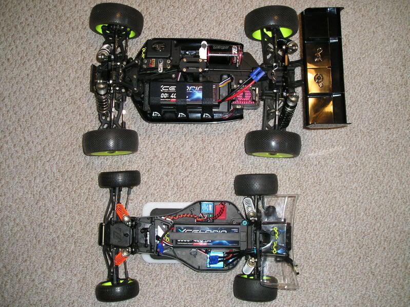

looks nice for sure Integra
here's mine, gonna be a week or two before I can get it to the track though, I still have some prepping to do on both anyways, Im going to run the xxx-cr this Wed night @ SmacTrac
I need some padding for the battery tray like your's Nick
Sweet ride! I always suggest to people to use industrial sting velcro on the battery--provides padding and much needed gription!
Put the loops (soft side) on the battery and hooks (prickly side) in the tray. Just an idea . . .

Originally Posted by dangerwr View Post
S
thank you and thanks for pointing that out, it makes sense.....I fixed the straps and added padding to the tray
