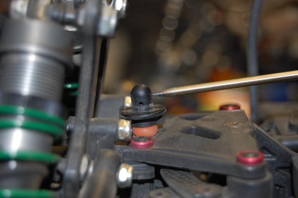

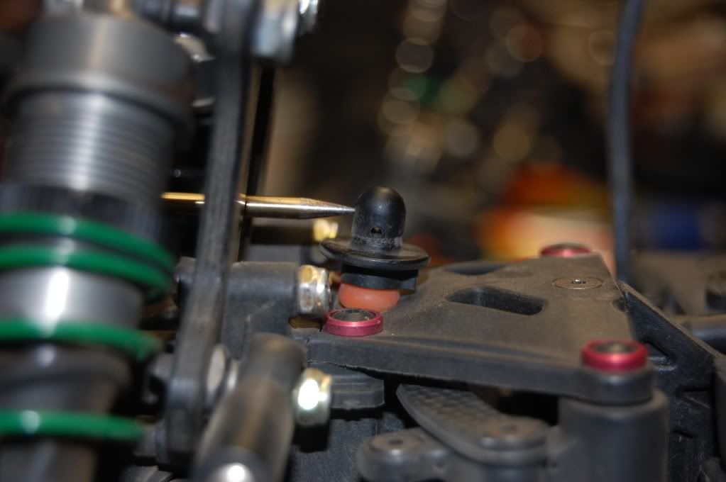

for the body Cracking issue in the front.....Take your steering top plate off....remove the short screw for the body mount and run a 10mm piece of fuel tubing and squish it pretty good with a longer screw and it act's as a flex mount...No more broken body's.
