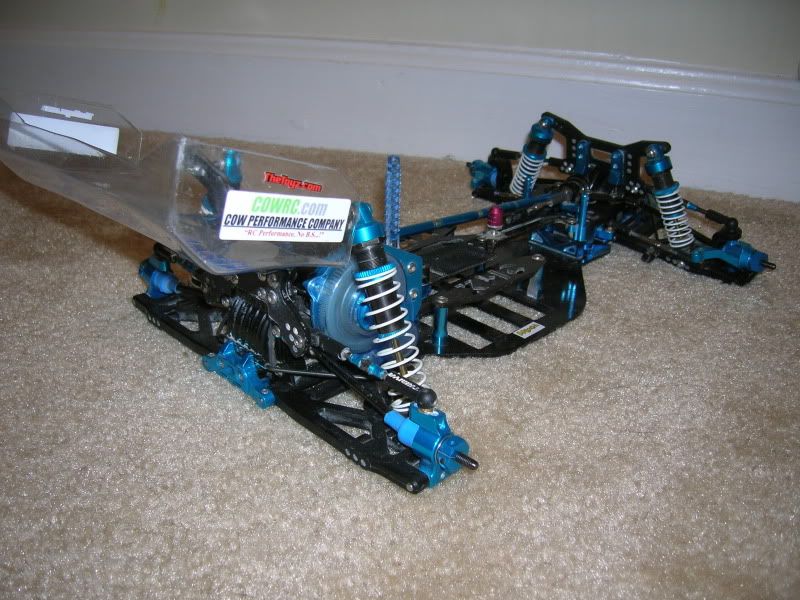

this is my DF03 that i posted last year. love it. its been a shelf queen for a while mostly because i cant find the gear boxes anymore. about 1-2 screw on each gear cover is stripped.

Are they the parts you need:
http://cgi.ebay.com/0004432-Tamiya-D...item519416ab9f
Very nice DF03 btw.

very cool, i was having a hard time finding those parts, will have to purchase some!

Did you use threadlock on the screws? I have read that threadlock ruins plastic. I guess you probabaly used tamiya anerobic gel. But just in case I thought I better mention it.
