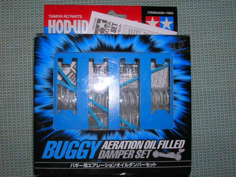

here are some more completed pics. I had a couple hick-ups in the building. i found out that i wont be able to use the lay down servo mounts successfully. the servo saver comes in contact with the bottom pate. wil have to she if i can get a different servo saver.
gotta find some ball studs to mount the shocks. the bottom ball mounts are bigger than the stock tamiya mounts. Does anyone know what size ball mounts i can use in there?
I also need to get a couple more turnbuckles for the steering links, and for the servo, since it so much closer to steering assembly.

If you're using Tamiya's standard size eyelet for the lower shock mounts, the ball studs *should* be the same size ball studs you use all around... What kind of shocks are those? They look like the shocks included in the MS kit but I couldn't really tell from the pics...
My MS DF-03 uses the standard ball studs that are used everywhere such as the ones used on the steering assembling, camber links, and the upper mounting eyelet for the shocks should all be the same size... Don't you have some from the standard DF-03 kit??? You can try some of those if you have some...
Tom,
the stock Balls are actually not the right size, its almost as if they used took the ball ends of a 1/8th scale. i thought that maybe they would be the same size as my Kyosho Twin Force balls, but they arent, they are a but smaller than them.
as far as the stock ones go. they are a decent amount larger than the stock brass ball ends that come with the kit.
those are the shocks that are on there too.
any ideas yet?
EDIT:
http://www.tamiyausa.com/pdf/pl/54028.pdf
as far as i can tell from the data sheet on these, they are 5mm balls, don't have any of those, unless 5mm is the stock size and im having a brain fart.. time to go to the hobby shop and test some balls out. :doh
